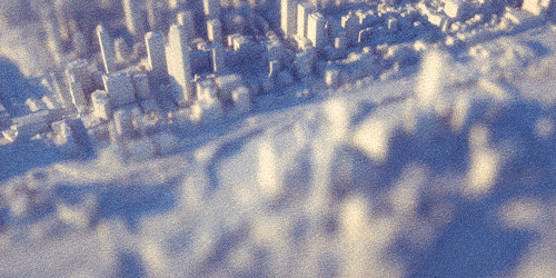

Lets see if animated GIFs work

Looks great, Al.
Let's call the breaking of all the input connections on scene reload as a feature. It gives everyone a chance to reconnect the nodes and spend a moment contemplating how cool free plug-ins are :D
