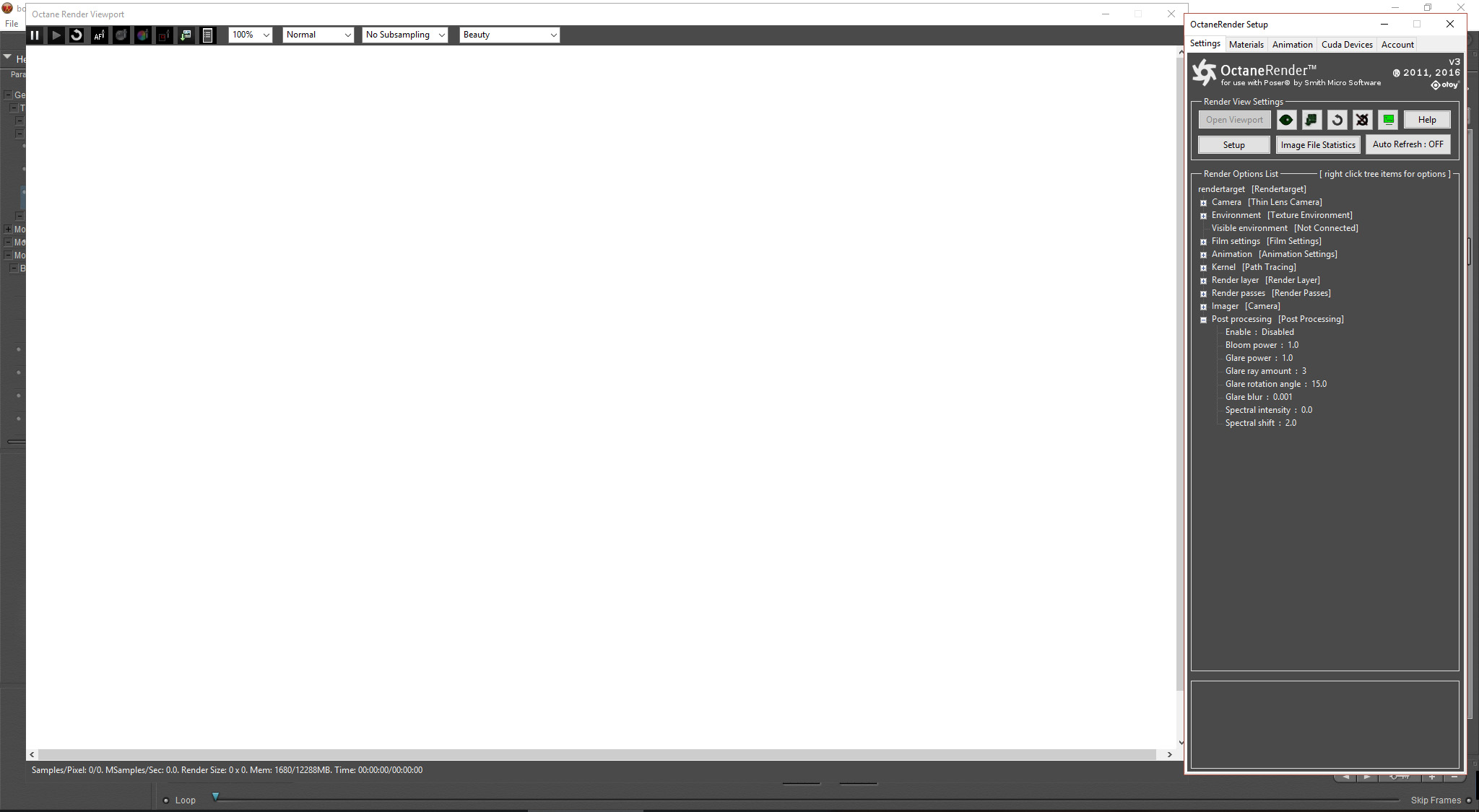

As requested, I've uploaded a screen shot of what it looks like now and has been since yesterday. Octane isn't rendering, and though NOW i can change the settings, it is so sluggish as heck but Task manager doesn't show it as suspended or any CPU load what so ever..
Something is seriously broken here.. betting on Poser being broke.. =(

I downloaded the stand alone demo and imported an OBJ and selected to render it, the 'render viewport' only shows wavy lines the octane logo.. no other images.
I have finally managed to load both Poser 2014 GameDev AND Poser 11 Pro (finally) onto my system. I have fully un-installed Octane plugin for Poser from both folders, rebooted and rebooted, shut down and rebooted again.. I did a proper re-install of the latest Octane version and still cannot get anything to show in the Viewport.. so the same problem persists..
If I load a new character into Poser while Octane is running, the Octane will do it's thing and show the new object in the materials list but nothing will appear in the preview..
That's the disconnect that needs fixing..
I patiently await.. =/ From the only error window I ever received, it appears that octane itself might have gotten munged somewhere along the way and now can't un-munge itself... ?
