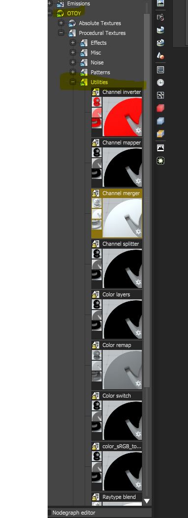

Hi terry i don't know if it helps, but standalone has some OSL utility nodes that i have never test , but could answer your request.
this is jobigoud code from channel merger

this is the one from channel spliter :
Code: Select all

i would start standalone and investigate this and try to copy paste those OSL codes in houdini to check if they could do the job.
cheers
