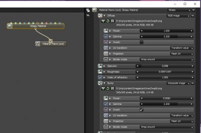

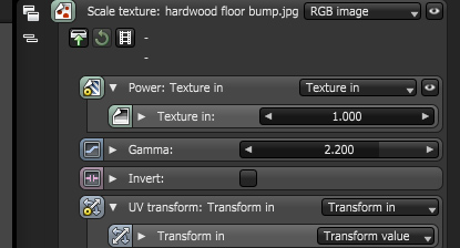

I've done some quick tests here but haven't managed to reproduce as yet.
When it loses connection with the images the paths are completely empty in the Octane node viewer (as below). You can recreate that just by moving one of the LiveDB textures into another folder.

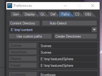

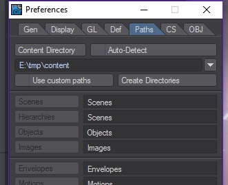

Ok. I've found a really weird behavior in LightWave that can explain the problem with the broken LiveDB texture paths.
At least here, if I load an image (using for example the image editor) from a folder outside the current content directory, LightWave changes the "Images" content folder automatically to the path of this image without notice.
This is what is breaking the LiveDB texture paths. They are stored internally using relative paths, and this change made by LightWave in the "Images" content folder without notice, destroys the texture full path.
Attached you can see what happens, and not only with the images ... loading objects from outside the content folder also changes the "Objects" directory path.
I think that the solution is going to be to use the absolute content folder as base path for the LiveDB textures ... the problem can be that after this change, the current materials available in old scenes will be broken, but I am not sure how to fix this problem without this change. Really I don't understand why LightWave has this behavior, that is not logic at all

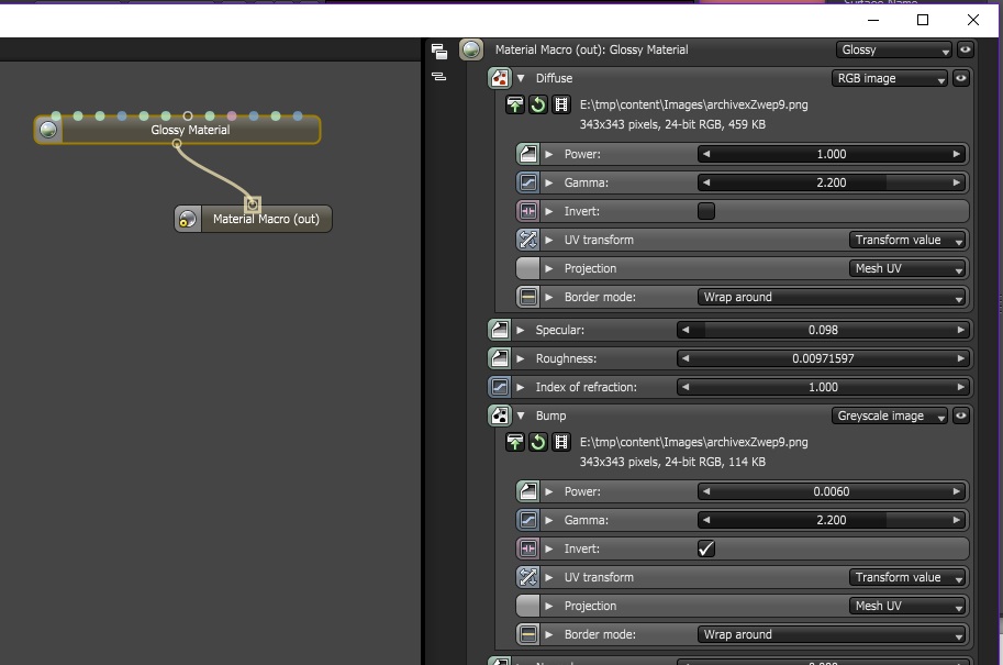

Ok. I've fixed this problem referencing the LiveDB textures to the main content folder, that is not changed by LW each time you load an image file.
The drawback is that the old LiveDB materials are going to lose the texture paths. I'm sorry for that, but really I cant figure how to fix this problem without break the old LiveDB material nodes. At least all should work fine from now on. It was a plugin design problem on my side due to not be aware about this weird and unwarranted LightWave behavior with the content subfolders, that IMHO should be always fixed along the project if the user doesn't change them.
Please, test it in the upcoming build and let me know if you find new problems with this feature.
