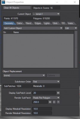

ristoraven wrote:Hi,
I have a scene where I made LW displacement terrain and added Octane displacement also to it. It renders well in IPR. IPR says there's well below million polygons in the scene. When I set Octane to render 18k cubemap, Octane says there's 30 million+ polygons and the machine freezes.. Had to reboot. I made an ORBX file and tested the scene in standalone and it works well there in 18k resolution. I also tried in LW 3840x1920 "stereo over-under" setting and the machine tilted for a while and then crashed and I got a dump file generated.
Tested with the latest 3.03 plugin.

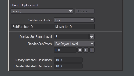

What are the your SubPath level settings? The IPR uses the display level, while the final rendering uses the render level. Perhaps they are not the same, like for example in the attached image.
Thanks,
-Juanjo
ristoraven
Posts: 390
Joined: Wed Jan 08, 2014 5:47 am
I have subpatches set to 20 and "pixels per polygon"..
juanjgon
Posts: 8867
Location: Spain
ristoraven wrote:I have subpatches set to 20 and "pixels per polygon"..
Well, this is the problem, you have a very high subdivision level for the final rendering. To have the same subdivision that in the IPR, set the Render Subpatch to "Per Object Level" and set also 20 on the parameter below, where you have now 258.
-Juanjo
ristoraven
Posts: 390
Okay, I changed to per object level and renders like a Rolls Royce.
Massive thanks Juan! You are faster than Lucky Luke.

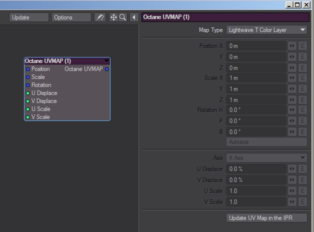

FrankPooleFloating wrote::? Juanjo, why does Box Projection not work on Displacements?... I want to use World Space on my cloned meshes' diffuse/spec/rough (seamless) maps, and also my (seamless) displacement map. In other words, why can't we plug the same Octane Projection node into all Texture:Image nodes and have them work the same for all?
Sorry, displacement only works with the object UV maps. The projection node is not compatible with it, I suppose that due to performance issues. Perhaps you could use the UVMAP node, that builds the object UV map at render time and is compatible with the displacement feature:
https://docs.otoy.com/Lightwave3D/?page_id=131
-Juanjo
FrankPooleFloating
Posts: 1669
Joined: Thu Nov 29, 2012 3:48 pm
Unfortunately, Octane UVMAP does not have World Space in Cubic Mapping... :cry:
Is this possibly going to change with new 3.1 goodies coming?.. It would really be huge to be able to use World Space, if nothing else, to hit boulders, bricks, and shit with displacements that make each clone/instance look unique.
Win10Pro || GA-X99-SOC-Champion || i7 5820k w/ H60 || 32GB DDR4 || 3x EVGA RTX 2070 Super Hybrid || EVGA Supernova G2 1300W || Tt Core X9 || LightWave Plug (v4 for old gigs) || Blender E-Cycles
juanjgon
Posts: 8867
Location: Spain
Perhaps you could try to use the UVMAP node using the "Lightwave T Color Layer" feature, and configuring a world space projection in the object color T channel.
