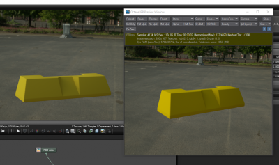

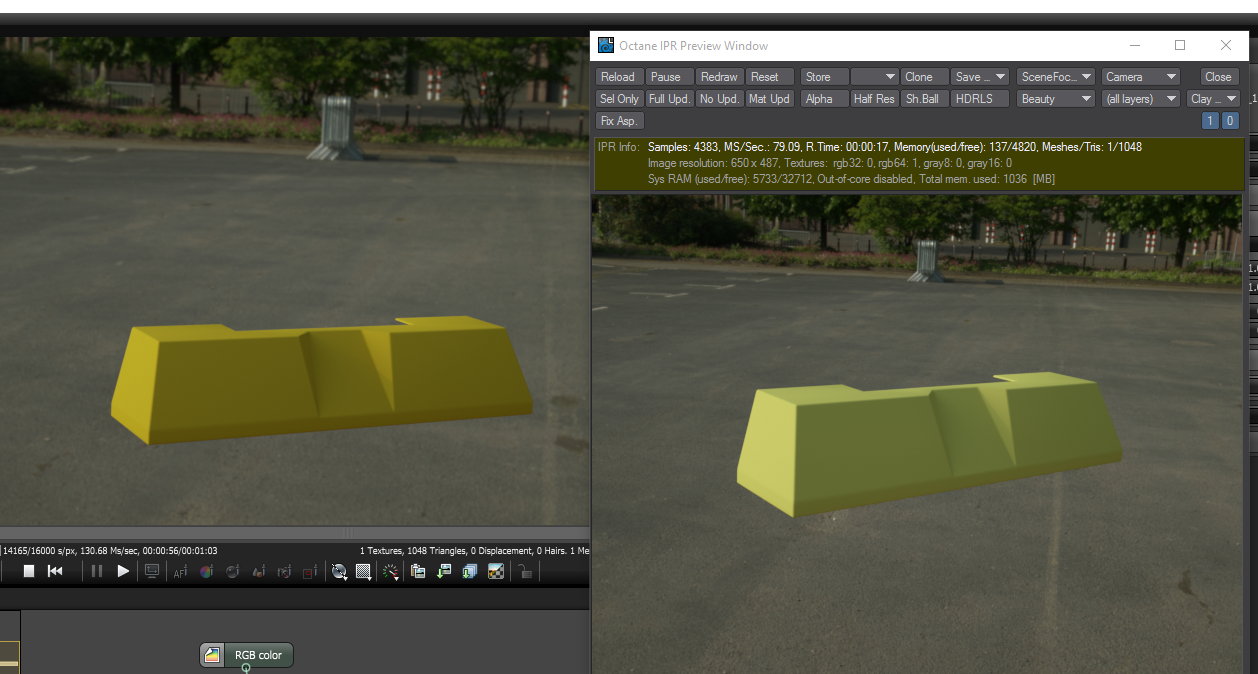

So this is what I was talking about. I still think the plugin renders colours differnt to standalone.
I have the kernels in these both set the same (as far as I can see). I have an HDR drining the lighting and as you can see, in both the HDR background looks to be exposed the same.
However, the colour of the object, which is an RGB node with the colour of F0B823 cut and paste into it (caterpillar yellow). However, the Lightwaver render looks washed out and lighter.

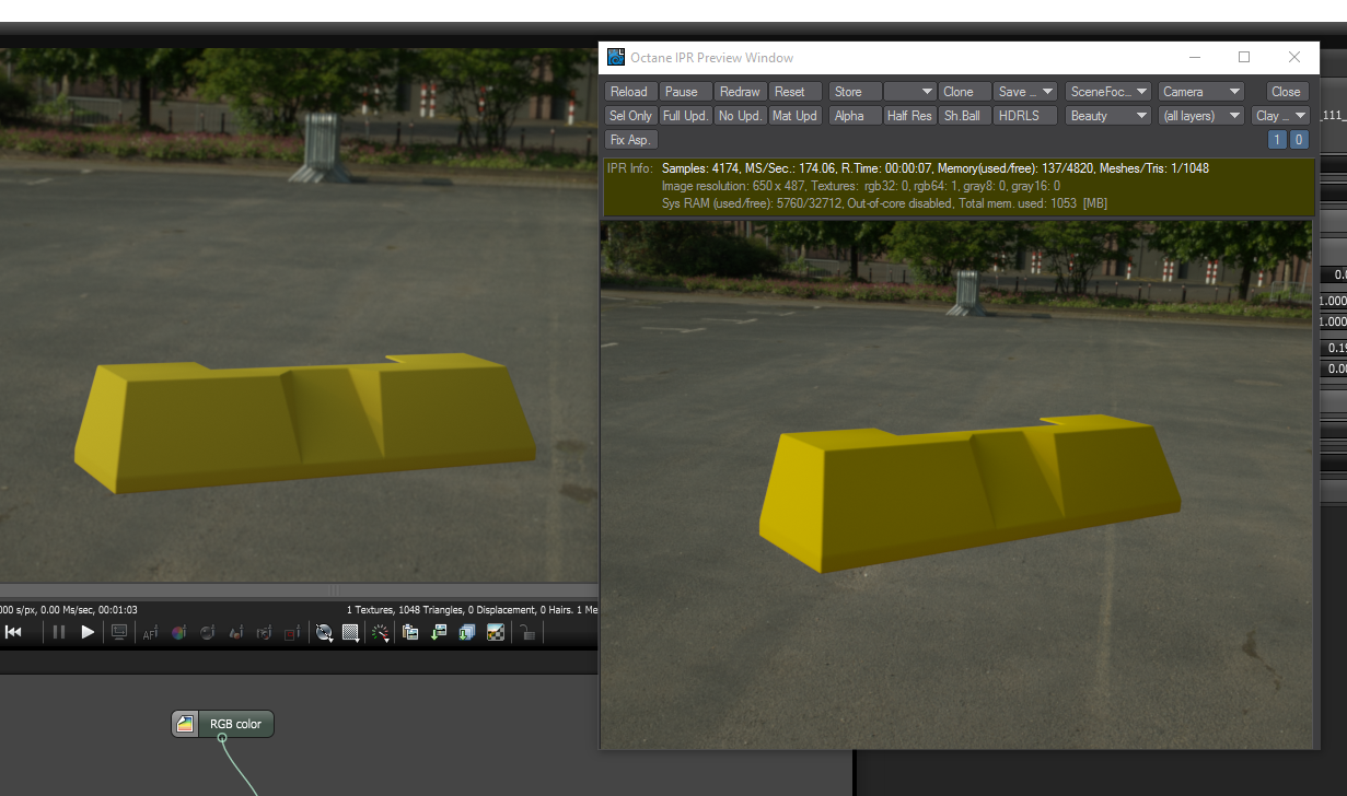

If I put an colour correct node after the RGB and make the gamma 2.2, this is what it looks like. The same as standalone.
Do you see what I'm talking about?
Lewis

Gordo are you turned off LW native colorspace option i.e. set it to disable to go to gamma 1.0?

I don't use standlaone but i know yu have to set LW ColorSPace to Linear (Disable) 'coz otherwise you are adding it twice when you use Octane settings.

Yeh, all CS disabled.
