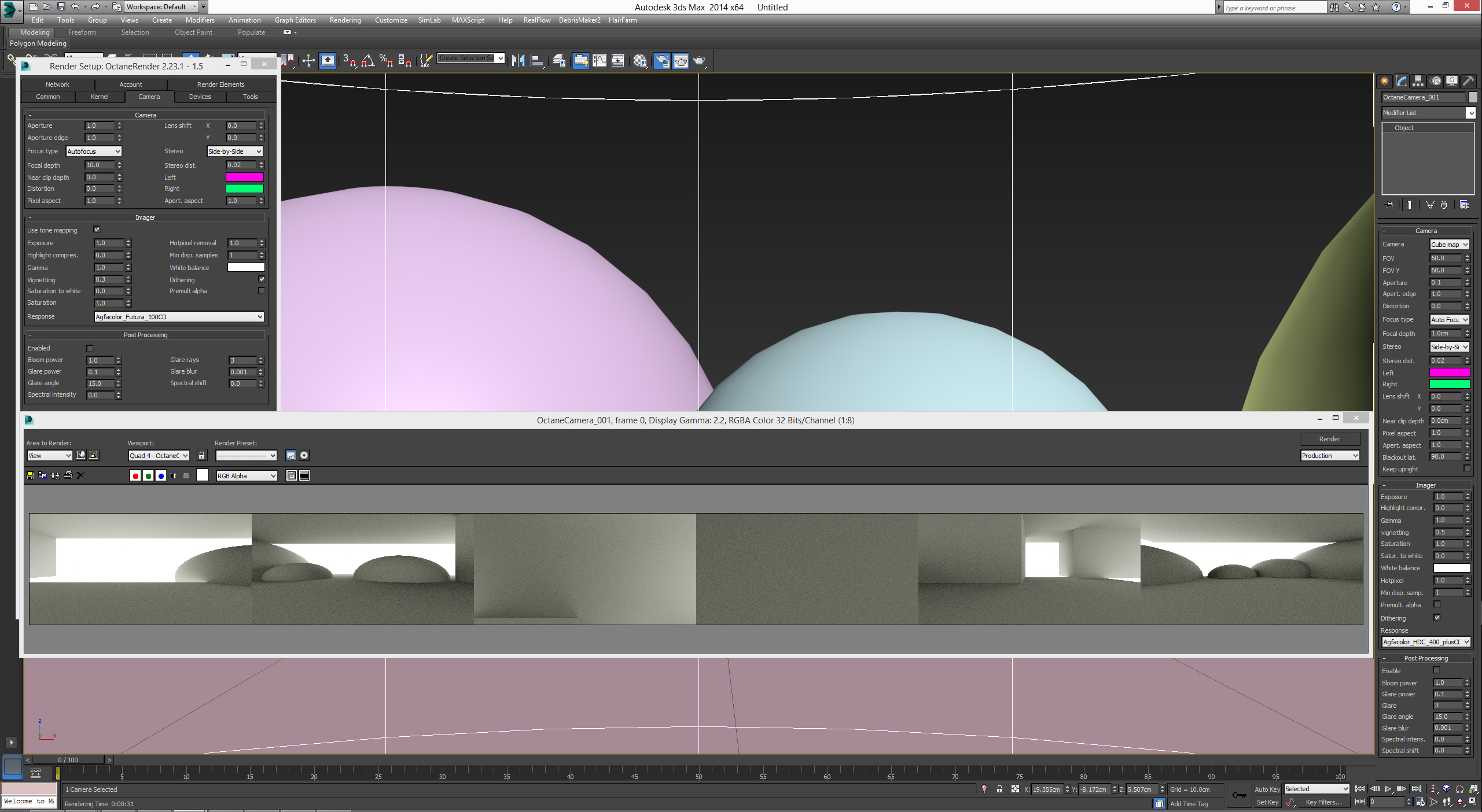

Thanks for the reply guys, I've attached a screengrab to show all settings and the render that I get. I've set the resolution, Cube map, Stereo - Side by side, but I still only get 6 vertical sections. Any ideas?

Would also like to know what Rico_UK is asking about, I set everything I could,
like in his screenshots, but there seems to be some missing element.

I've not used Max but it seems like a selection somewhere is wrong. The camera itself needs to panoramic which it looks like but your fov and fov v need to be 360 and 180º. I can't see what resolution you have set as output but there are two GearVR presets under Virtual Reality.

Yes I have seen those gearVR settings in Octane standalone, but I don't see
them yet in the max plugin.
Max plugin seems to be missing the panoramic camera setting
and gearVR stereo cube map setting (although we can just enter the dimensions)
Are these features coming to the max plugin?

I migh have missed something, but I think 3dsMax plugin wasn't updated yet..
but simply export scene as .orbx & render out in standalone for now =)

I just rendered a GearVR Cube Map 9216x1536 in 3dsMax :)
So for now I won't have to goto Octane standalone until I want a pano render.
Like a previous comment from 360precision, need to set
FOV: 360
FOV Y: 180
resolution: 9216x1536
and camera to Cubemap...we still don't have a panoramic camera choice.

Rico_uk wrote:Thanks for the reply guys, I've attached a screengrab to show all settings and the render that I get. I've set the resolution, Cube map, Stereo - Side by side, but I still only get 6 vertical sections. Any ideas?
I have the same problem in the Blender plugin, no matter what I set the stereo mode to it will only generate 6 tiles. :?
