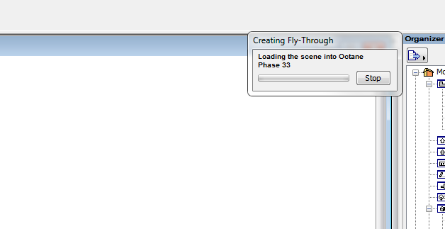

Hi Paul,
Finally I got it now.
It was still little confusing to me, because whatever settings the popup window says
"Loading the scene every into Octane".
I did this test with different settings to make sure what settings work best.
The scene I used is with an with animated car
and I rendered it (2000x1000 px, 400samples/pixel) a lot of frames to see how many frames it would render per minute to compare.
I set 'rebuild' on (tests 1-3) to see when car animates
"Loading the scene every into Octane" takes about 3-4 seconds
I set 'rebuild' off (tests 4-6) to compare rendertimes
"Loading the scene every into Octane" takes about 1-2 seconds
Conclusions/assumptions:
- So the scene is always loading, but probably not the geometry when having rebuild 'off', right?
- To animated objects... both, OctaneRender Setup Window and Viewport have to be closed
- to have fastest rendertime for animation without animated object can better be open
Belowe are my tests

Hi Jeroen
One day I will work out how to make this easier to understand. But unfortunately an ArchiCAD plugin cannot talk in any way to an ArchiCAD Renderer - so the Octane plugin Setup window cannot talk to the Octane Photorenderer - so the current slightly confusing implementation is what we get. I was thinking maybe a text box on the Setup window Render tab of the plugin to say "Rendertarget Not Loaded - Photorenderer will load the entire scene" OR "Rendertarget Loaded - Photorenderer will use the scene currently loaded in the graphics card". But maybe that confuses people more :-)
The "rebuild" setting will only have an effect if the "Photorenderer Settings" Octane View is different from the current AC selected View
Correct
Correct
