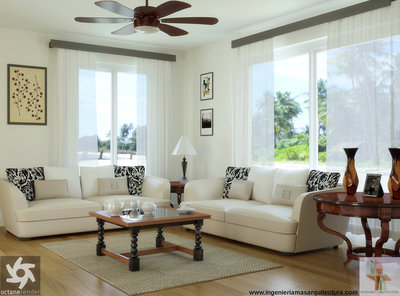

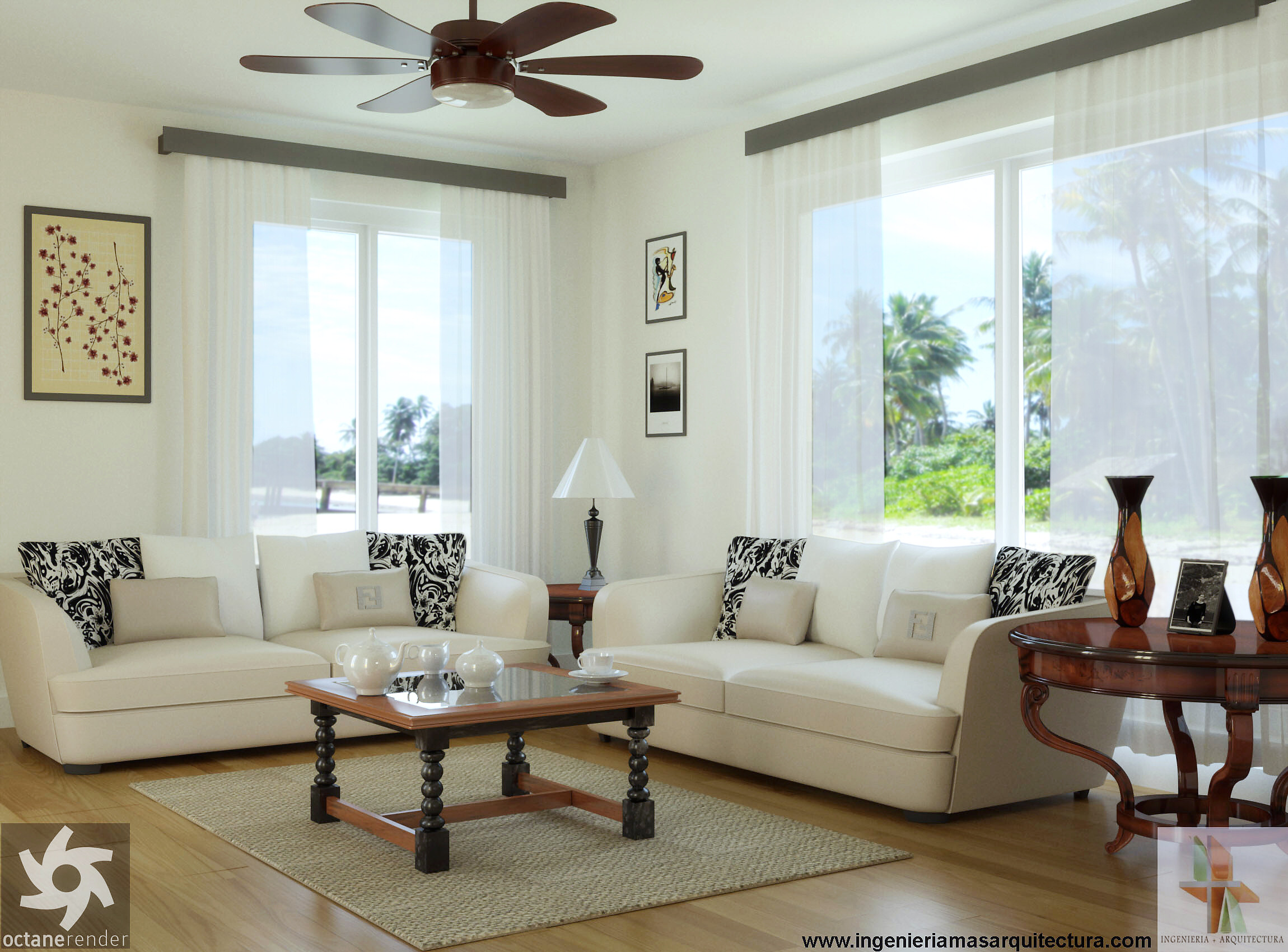

The interior holds a very high quality while the outside is heavily overexposed and low in resolution, almost look like watercolor compared to the rest of the image. If you want to imitate a photo overexposured outside is ok, thats the way a photo with correctly exposed interior will look like. If you want it to be more eye-pleasing a little less over-exposure will look better. What I mean was that you could try to replace the outside in photoshop using an alpha channel from octane. (I have not tried to create an alpha channel in octane myself but I think it should be possible in the deep channel render kernel). I´m afraid I have no advice on printing, my renders usually stay in small size on the web, lol.

I hope you not get offended by me posting a changed version of your image, I know you posted in the main gallery and not the wip section. I just want to show an example of what I tried to explain earlier. (unfortunately the curtains is not good in my example, they are very hard to fix in postwork)

wip section ? what means that ? not offend me at all, thank you for that image, but, how i can do the post production ? can you help me explain me step by step ?

where i can get that background images ? is hdri ? or just an image with a lot brightness ?

paoloverona wrote:woow Merid, really a great emprovement!
I don't know if the yellowish color is intentional, but I think that it's not too good if you aim photorealsim.
you should have play a little bit more with the camera response or the color temperature of the light outside the windows to avoid all the yellowish color.
I've done a fast test with photoshop for comparison.
Cheers, Paolo
Is the camera response how one can do white balancing in Octane?
White balance is a feature that will be coming soon, part of the post effects that are being added.

hi nehale, i think so do things more white is my problem, enrico cerica use AO, honestly i don't know make the mix into photoshop, enrico use a few images mixed in photoshop, i think so, post production, that is the reason why him have walls, celing and more things very white
