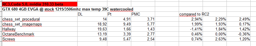

Results for RC3 on EVGA GTX 680 4GB watercooled OC
The hallway numbers still seem wrong to me. With RC3 I achieve on one 690 GPU on Windows 7 the following sample rates for the hallway scene:
PT: 2.10 Ms/s
PMC: 1.73 Ms/s
DL: 18.82 Ms/s
So something is going wrong in your system. How does it behave if you don't overclock? Did you disable Windows Aero, SLI and PhysX? The latter shouldn't make any differences, but you never know...
