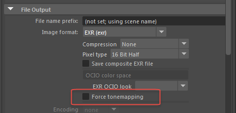

zurakan wrote:hello
Can you put tonemap hdr option back?
or i can find some where this option ?
thank so much
It is here:

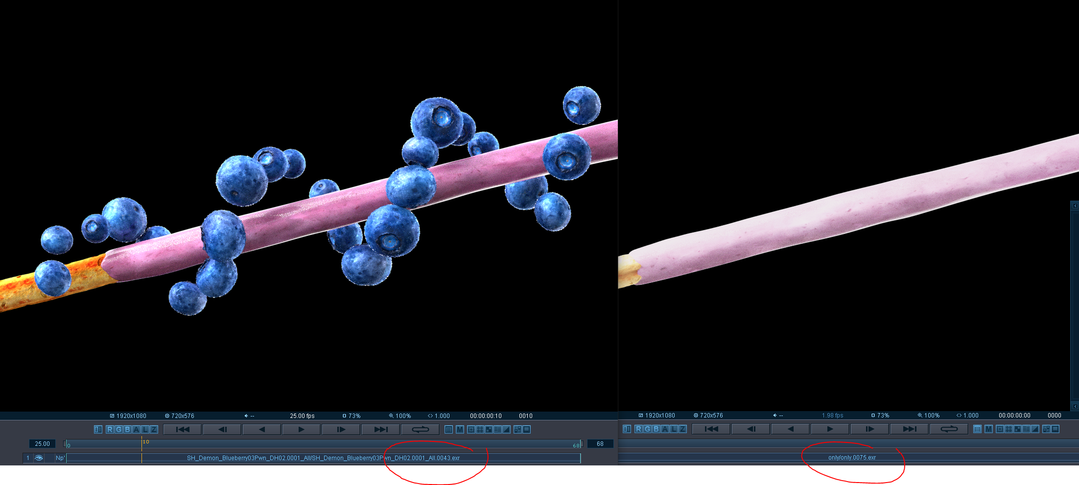

Gamma in octaneImager is not effect to render,
i try to use Ocio but 2020.2.5 i can not use batch render
now i use 20.20.2.1 and 19.17 it can .
but some time image from render , same setting (Ocio),But have render layer and no renderlayer (the blueberry no renderlayer )

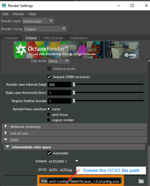

Hi Zurakan,
Thank you for the video!!
Could you please check if there is an OCIO config file loaded under the RenderSettings>Octane tab>OCIO rollout?
Usually, if there is an OCIO file loaded then we disable the Tone Map settings internally.
- Please make sure to keep the OCIO file path empty
- Save the file and Re-open and see if it fixes the issue.
- By the way, how are you animating the blueberry? please make sure to set the animation as *Force Load* on the Animator Data!
Please share a sample file for us to test on our machines if the issue still exists?

Hi Zurakan,
Thank you so much for attaching the video and the scene.
Octane Imager's Tone Mapping will not work along with the OCIO config.
Your scene worked fine on our test.
The Gamma would also work once you unload the OCIO file from the RenderSetings>Octane tab>OCIO rollout
Please refer to this link below for the correct OCIO workflow:
viewtopic.php?p=403379#p403379
cheers
