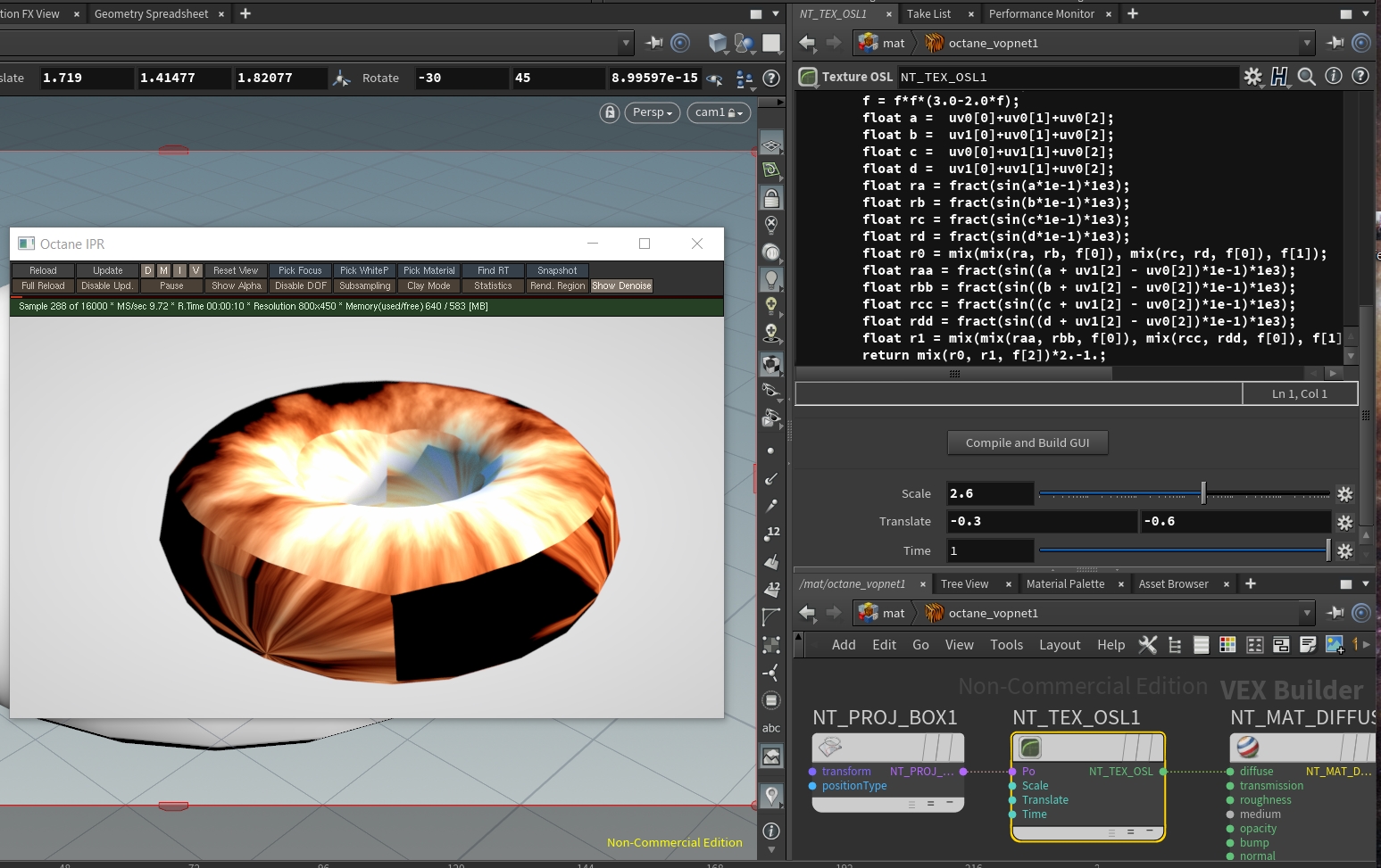

Postby efxlab » Tue Apr 14, 2020 12:24 pm
efxlab Tue Apr 14, 2020 12:24 pm
I dont understand ? how I move the OSL utility shader from LiveDB in houdini ?, Copy take a XML htmlentities text, not well formated for OSL node. Drag and drop no work, and the import button does nothing
efxlab
Posts: 54
Joined: Thu May 31, 2018 5:23 pm
Re: OSL in Houdini with liveDB
Postby juanjgon » Tue Apr 14, 2020 6:26 pm
juanjgon Tue Apr 14, 2020 6:26 pm
Ah, sorry. Yes, true. Currently, you can't download these OSL textures directly in the Houdini plugin because it only supports material type liveDB nodes. I'll take a look at this limitation at some point, but meanwhile, you could open the liveDB OSL texture in the Standalone and copy/paste the OSL code into the plugin OSL VOP node, as you can see in the attached images.
