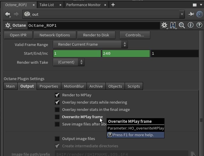

Hi, using octane for houdini for the first time. Pardon my ignorance in case this is already possible for some reason, but I'm frustrated that as im rendering my frames are not saving to mplay, it will only show the current frame that i am rendering, and the rest just save to disk. I'd love to be able to preview my animations in mplay.
any chance of changing this?

This is already possible. You only need to disable the "Overwrite MPlay frame" option in the Octane ROP node.

sweet! thanks juanjo. great work btw :)
