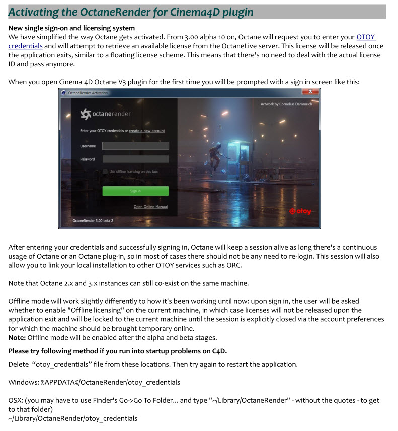

Is there still someone with login issues? Please describe your OS too.
As a workaround, i created V3.0-R1.1 which fixes an bug on plugin.
And an old beta version(Beta2.1) is on release page. You can try if you still have problems. Please give me info about your last status.

Hi Aoktar,
yes still having issues here.
Standalone 3.0 launches fine - no problems now. In C4D I am asked for credentials. When I hit ok C4D Plugin says that all my licenses are being used. This is false.
I somehow need to free this mystery C4D license so I can use it.
I am using Octane standalone 3.0
Octane C4D Plugin 3.00 - R1.1
Windows 10

Hi creaturechaffe,
can you check this? Have you see this login window on start of C4D? And did you give your Otoy user ID/pass not plugin license numbers?

sorry but this does not fix it for me
I deleted the suggested file which in my case was in C:\Users\OC\AppData\Roaming\OctaneRender
I was previously testing the plugin on my machine at work which was de-activated and shutdown. So its definitely not active.
So unless that activation gets de-activated how will this work?
also yes I am using my credentials to log in at the splash screen.

I suppose until June 1. Informations on release post might be enough in normal case. But it's messed up and don't know exactly what's happening. Propably some unexpected cases due Operating systems.
If still someone having trouble please send me PM. It will be better to follow up the case.
