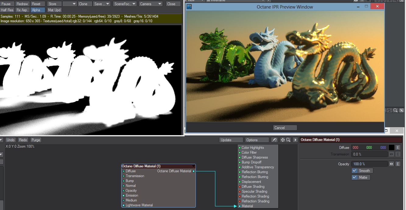

geo_n
Posts: 350
Joined: Tue Feb 02, 2010 5:47 am
juanjgon wrote:
geo_n wrote:Is the shadow catcher node or shadowdensity alpha supported?
Plugins currently only can support the nodes available in the Octane Standalone App. Are this nodes available in the standalone?
-Juanjo
x32 working fine now I removed octane master.
Re shadow catcher, I think this is possible with matt material
http://render.otoy.com/forum/viewtopic. ... ss#p142204
"The shadow should be in the alpha channel to allow compositing, using the matte option for the floor object is the way to get this effect."
Should be a sticky or have sample scene demonstrating this very important function.
Happy New Year!
