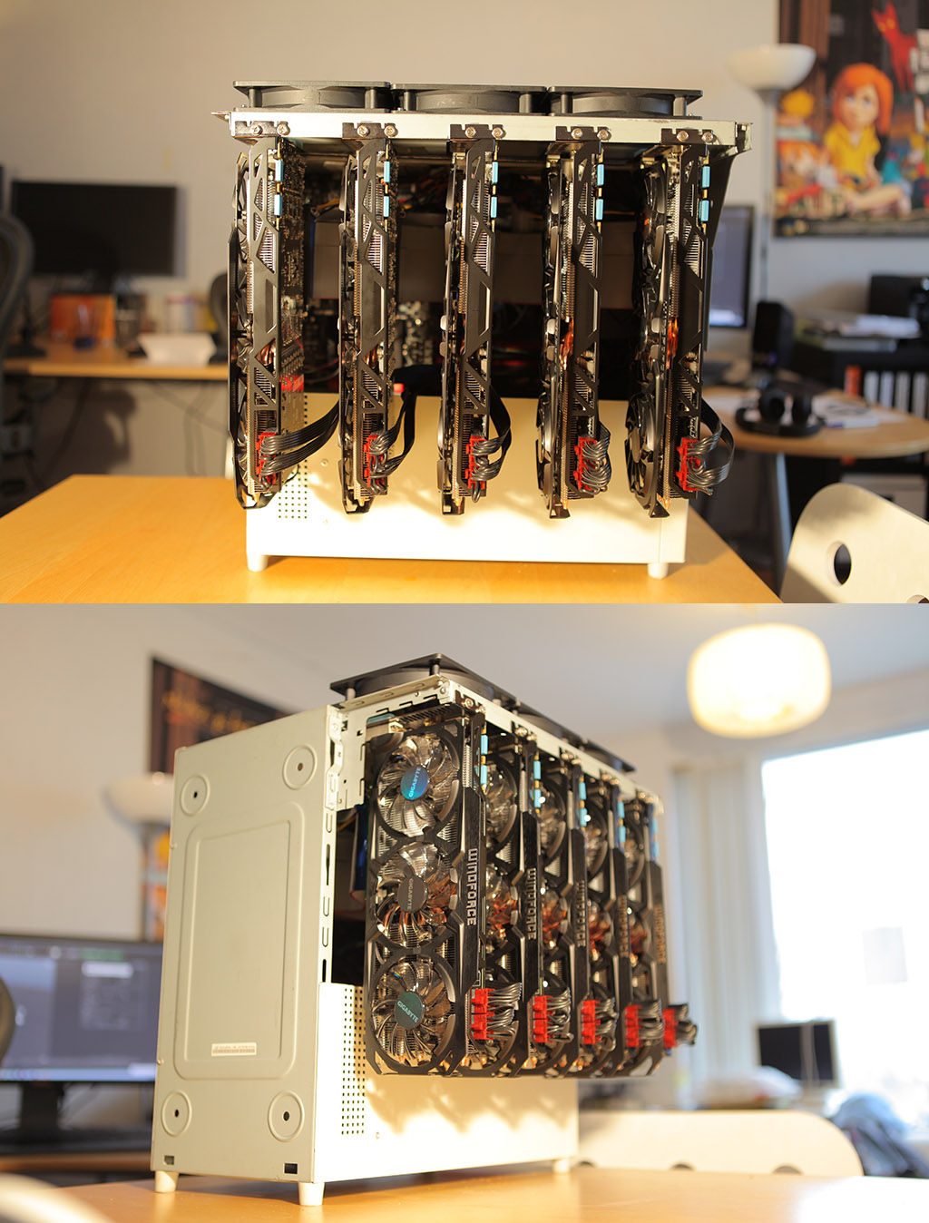

Here is our Octane-PC: a
intel i7 4770
5 x 780 TI @1160 mhz
16 GB ram
Asus Maximus VI extreme
And 2 meters of aluminium foil .
We searched for a nice solution for 5 videocards but couldn't find something that we wanted. So we decided to build our own case (photo attached). This case is made out of 2 old computer cases. We used risers to get the cards out of the case. When we where done building we tried out our new system,..... only problem was, the computer didn't work.
After a lot of testing we found out that the risers caused the problem. The risers we not good enough shielded.
The solution was do put aluminium foil around the risers. At the moment it seems that they are properly working.
So if you are going to use risers, buy good shielded ones =D.
Also we found out that max tdp doesn't mean max watt. So something this system peaks a 2200 watts of a very short time. This only happens during shading and test rendering. It doens't peak this high when rendering an animation (dunno why).
The cards that we are using are the overclocked 780Ti windforce (the cards run on 1160 mhz when rendering).
But even with this overclock the temps are between 40-55C (full load) depending on the card (idle 19-20C).

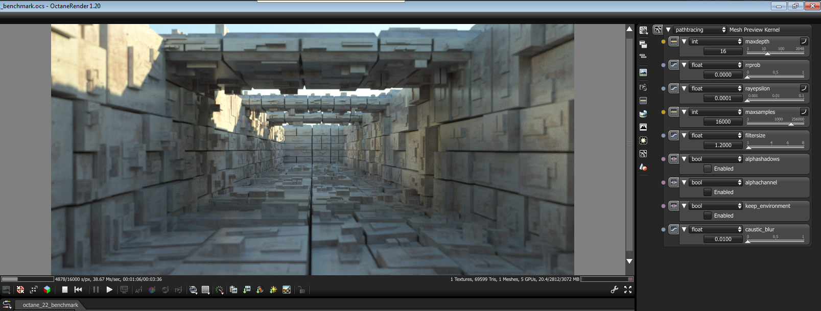

Version 1.2:
pathtracing 38.67 Ms/sec

.. cool setup, good info on the shielding of risers - I'm using them with gtx 580s, my mainboard is the Asus P6T7 WS with 7 PCIe slots - and I had issues when connecting the 590 gtx card via riser (the system did not recognize)
- also - did you use those risers with additional power (or is it for more power hungry cards)

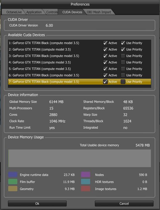

Hi guys-
I just re-tested my "uber rig" I have here at work. This workstation has seven Titans using a Netstor breakout chassis. I've upgraded four of those Titans to Black Editions. Great cards if you can find them. Super hard to find now but I'm sure that'll change. This rig is doing a 61 in Pathtracing and a 45 in PMC. DL is over 200 and I can't get a screen grab because it's over before I can catch it! Funny. This machine can RENDER.
Alec
Alec

Great results ! Could you please measure how much faster is single TITAN black compared to TITAN ?
BorisGoreta wrote:Great results ! Could you please measure how much faster is single TITAN black compared to TITAN ?
Sure! Good idea. Just tested. With one normal Titan in Pathtracing I'm getting 7.8 or so. With the BLACK Titan I'm getting 9.5 in Pathtracing. That's more than I thought It would do. Isn't that like 15-20% faster? I'm impressed. I wonder if that's the same score as a 780ti? Anyone want to run a single 780ti to find out? Curious.
