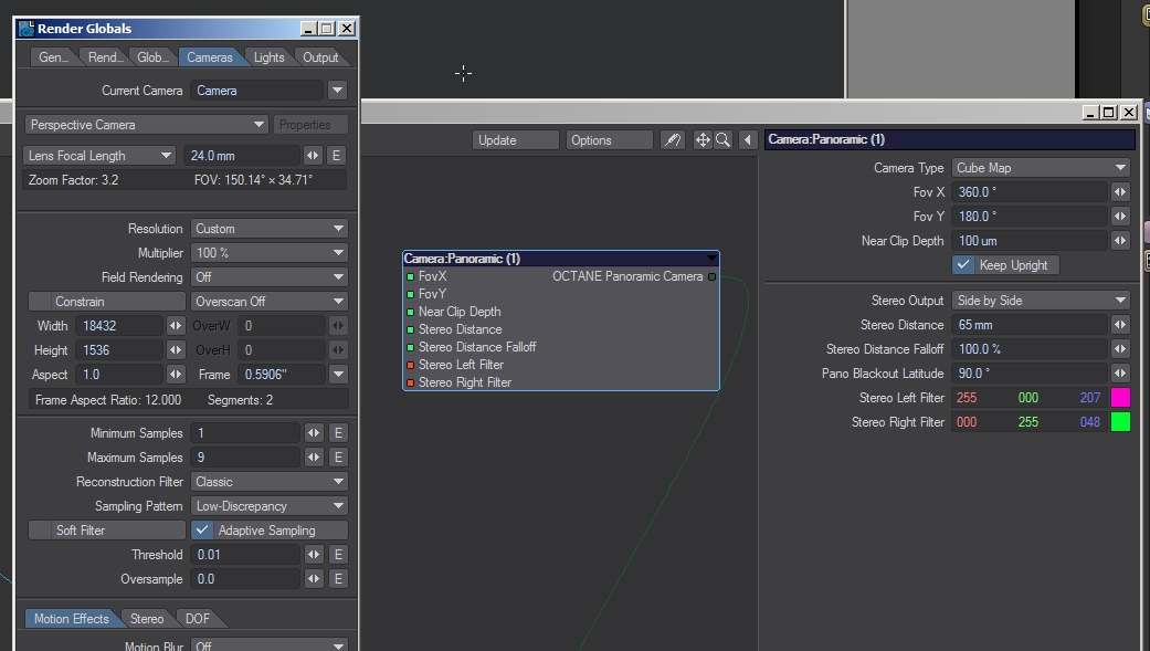

In the panoramic camera you can set the camera type to "Cube Map", set the Fov angles to 360x180, enable the "Keep Upright" option and set the Stereo Output to "Side by Side". Also you need to set the camera resolution to 18432x1536. Attached you have a capture of this settings.
