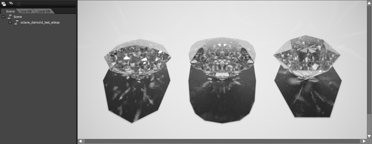

Is your caustics blur set to 0? I did forget to mention that one.
I remember having a scene-test laying around, with diamond assets. I remember that I abruptly stopped the on-going rendering calculation being the reason why there is still some visible "noise" (lack of samples). Yet, the shadows are sharp as well as both reflective*/refractive caustics
*In the surrounding area, around the diamonds.
