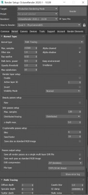

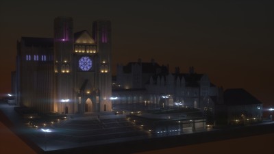

I’m having trouble with Octane Renderer for 3D Studio Max. I've searched all over the web and there are a lot of "my render is grainy" posts but nothing seem to work. No matter the values I give the Kernel or Camera, my renders are still coming out incredibly grainy. This is the result of a 30 minute render on an RTX 2080.
What am I doing wrong? How can I remove this fuzzy, grainy quality to the image?

I'm not a MAX user, but off the top of my head, I'd suggest first turning on the AI light, since this is exactly the sort of scene it works well on, enable Adaptive Sampling, and I'd also reduce your GI clamp to something like 10 or 100. If the AI light doesn't do much for you, you may want to simplify the shape/number of polygons on light emitting geometry, plus manually set your Sampling Rate for each emitter, to give priority to the ones that matter most.

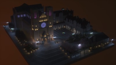

That made it much, much worse.

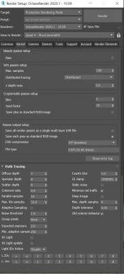

I tried all three of your suggestions at once. Any combination of the 3 leads to a crash.

You have many, many lights in your scene, but you really should not need 15,000+ samples to get a good looking image. Some light sources are more important than others, and you need to figure out how to use them optimally. It is not a trivial problem. Normally, the AI Light does a pretty good job of this, but not always. As I mentioned previously, I suggest you isolate different logical groups of light sources and see which ones contribute the most to overall scene illumination, and which contribute minimally to inter-object illumination. Then use the Sampling Rate for each source to weight them accordingly. The Sampling Rate is a relatively weighted value, not an absolute value. It doesn't matter if you use 1 and 0.1 or 100 and 10. They have the same relative weight to each other.
You should be able to get a much cleaner image, much faster than what you've got now. In addition to optimizing your lights, definitely read up on Adaptive Sampling, Denoising, AI Lighting, and the GI Clamp value. Since you are having crashes, you may also be running into a low memory issue, and may want to look into Out of Core RAM use.
