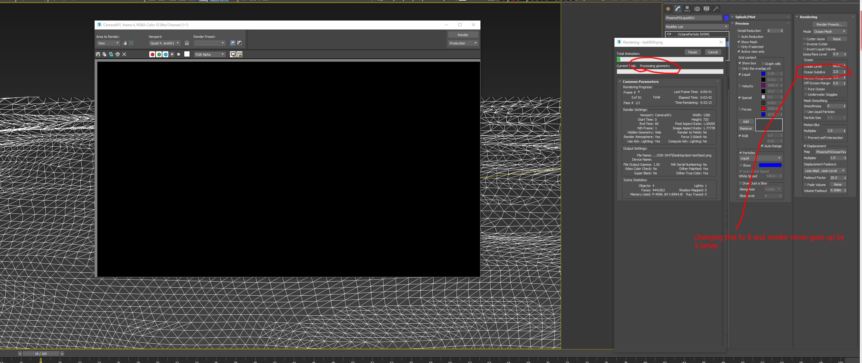

could you look at this scene and render the animation. When subdivision level is set to like 4-5 render times get very very slow mostly because of initial geometry processing every frame. is this how octane does and nothing can be done?
If you can just simulate 50 frames and then render you will see slow processing times Thanks

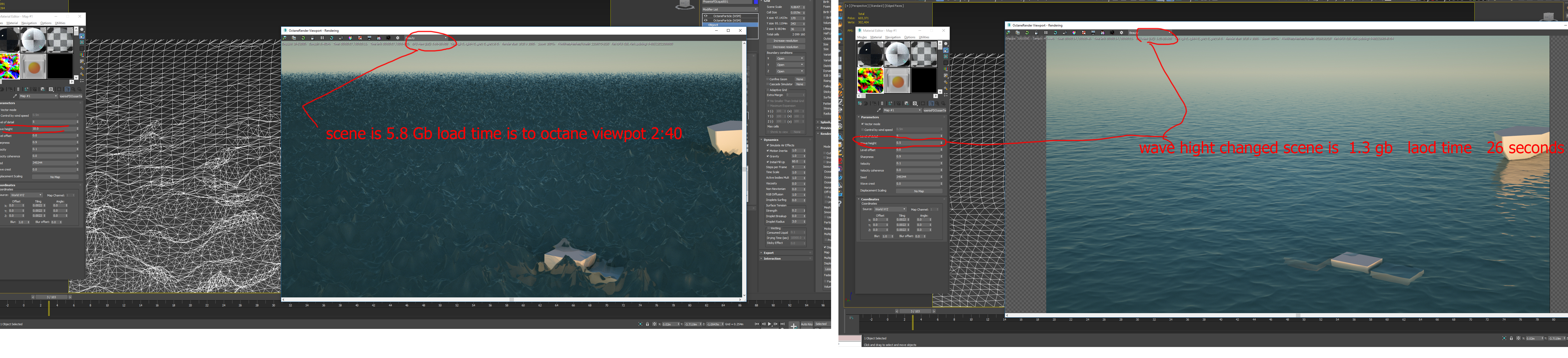

1. Here is another example. Changing waves height in phoenix ocean map changes wave displacement making scene go from 1.3 gb to 5.8gb but why load time go up so much. Almost 3 min to load 6Gb of mesh to the vram? why so slow
