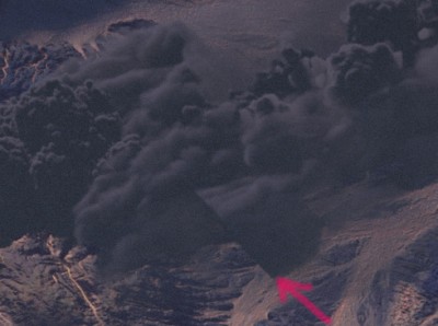

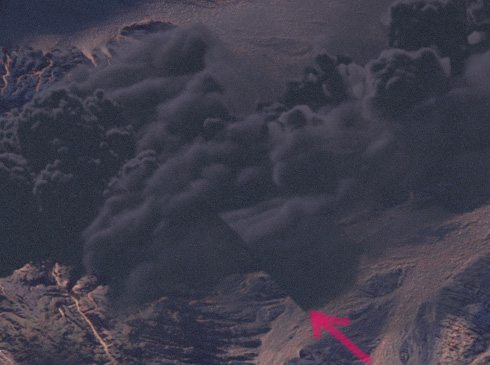

i am encountering issues when overlapping separate volume objects.
attachted is a zoom of the problem. some of the containers are being sharply cut off.
Volume overlap problem

Hi crackfox,
this is not an issue, volume intersections could be difficult to render.
They should have similar characteristics, such as volume step lenght and volume grid.
About this may refer this link:
viewtopic.php?f=6&t=58354
Regards
Paride
Regards
Paride
any way to fix this in the future where octane will blend two volumes We are planning to do fire and smoke animation with lots of grid boxes and some will overlap. Does all renderers have this problem like vray etc ?paride4331 wrote:Hi crackfox,
Regards
Paride
