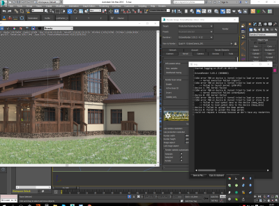

Started logging on 29.07.16 13:56:33
OctaneRender 3.03.2 (3030002)
CUDA error 2 on device 0: The API was unable to allocate enough memory to perform the requested operation.
CUDA error 2 on device 1: The API was unable to allocate enough memory to perform the requested operation.
-> failed to allocated device memory
device 0: failed to upload data texture 4 of context 0
device 1: failed to upload data texture 4 of context 0
device 1: failed to upload data texture 30 of context 0
-> failed to allocate device array
device 1: failed to upload data texture 31 of context 0
CUDA error 700 on device 1: Kernel tried to load or store to an invalid memory address. The context cannot be used anymore and must be destroyed. All existing device memory allocations from this context are invalid and must be reconstructed.
-> kernel execution failed (report)
-> failed to launch kernel (ptBrdf2)
device 1: PMC kernel failed
CUDA error 700 on device 0: Kernel tried to load or store to an invalid memory address. The context cannot be used anymore and must be destroyed. All existing device memory allocations from this context are invalid and must be reconstructed.
device 0: PMC kernel failed
-> failed to load symbol data to the device (deep_data)
device 0: failed to upload the deep params
device 1: failed to upload the deep params
could not request a tonemap because we don't have any renderthreads available.
bug v3.03.2 - 4.12 [TEST]
C. RAM Capacity (i.e. 6 GB)
- Elvissuperstar007
- Posts: 2506
- Location: Ukraine/Russia
- Contact:
- Attachments
- octane 3.03.2 160729 184827.log
- (3.52 KiB) Downloaded 248 times
win 7 /64x C2Quad 6600 2.4/ Nvidia 9800 GX2 1gb 512 bit + Asus 480 GTX/ DDR2 8Gb / NVIDIA 460 GTX 2GB/2x NVIDIA 580 GTX 3GB
- Elvissuperstar007
- Posts: 2506
- Contact:

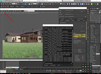

это происходит с регион рендером, после я даже сохранить не могу рендер..блин рендерю раз 10 уже, памяти хватает судя по скрину
- Attachments
- octane 3.03.2 160729 223320.log
- (1.72 KiB) Downloaded 255 times
