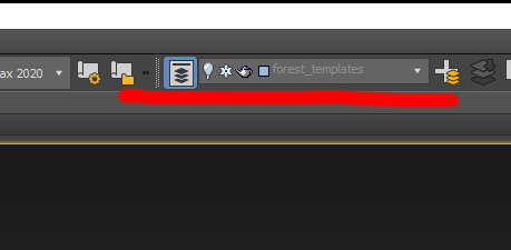

We used to add all our itoo reference mesh to FOREST_TEMPLATE layer that was set to hidden and nonrenderable and itoo used to show up during rendering. Now we have to make sure source mesh must be present and set to renderable. I am not sure what happened.

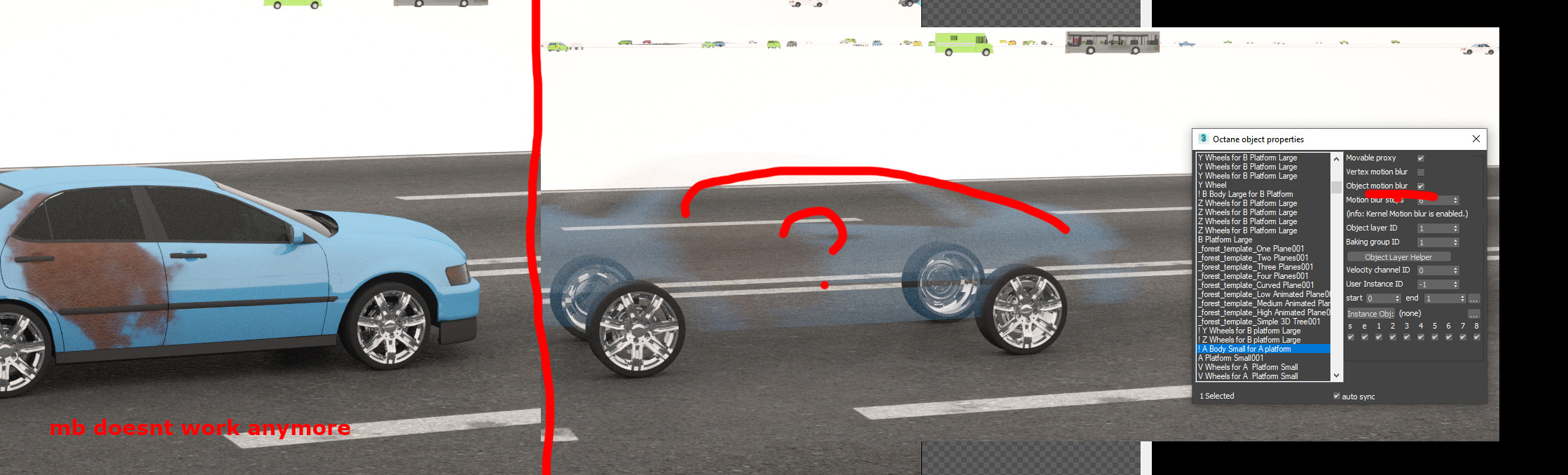

IMPORTANT: itoo cars don't get updated during animation. They are static. Only if I scrub a timeline they will
UPDATE 2: It looks like we have to check movable proxy for itoo to be animated but now motion blur doesn't work. Objects turn clear. It used to work in octane 4. Please fix itoo. It has too many strange confusing bugs and settings
