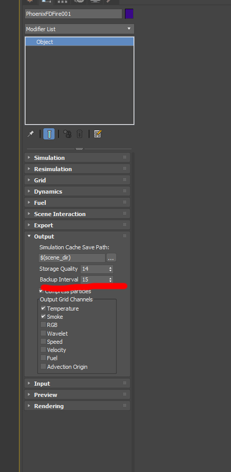

darkline wrote:still producing render glitches with phoenix (Max 2014) demo version of Phoenix FD 3.03
Try to set backup intervals to 0. Seems like this glitch happens every 15th frame. Maybe it will fix it. I have the same problem with wetmaps when octane will render wetmaps to whatever backup interval is set to freezing the renderer. Hopefully otoy will fix these 2 bugs.

Ok So I've upgraded to the latest octane and the new trial version of Phoenix 3.1 and can say that these glitches occur every 15 frames.
Even if I open the octane framebuffer the glitch appears there too. If I render out a single frame, the glitch also appears

Coilbook, I love you. :-) Ive literally spent the whole day, simulating, rendering, re-simulating, rendering, installing different versions of octane, upgrading GPU drivers, installing security updates to let even newer versions of octane install, and installing different versions of Phoenix - none of it helped and it all came down to this little bug! Thank you!!!
