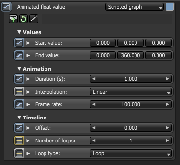

Please try this "Animated float value" node and let us know if it works for your scenario.
It's still a work in progress and I'm still tweaking the way it works for multiple loops and ping pong animation but if you need one 360° it should work.
Plug it in the `Angles` field of a 3D rotation, and set the start value to 0, 0, 0 and the end value to 0, 360, 0, for example (see ORBX).
