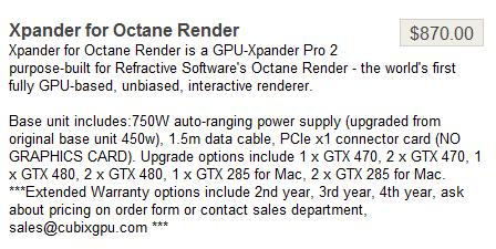

PCIe x 8 slots, not PCIe x1 ! This has to be confirmed, but it is written.
But I read PCIe x1 connector card here:
from Online store
from Online store
radiance
Posts: 7633
our units here came with 8x PCI-E and they work fine.
i believe they have both 8x and 1x options.
You should be able to use octane just fine on a 1x PCI-E connection, you'll just have to wait a minute instead of 2-3 seconds for the mesh to appear when you first click on your meshnode.
