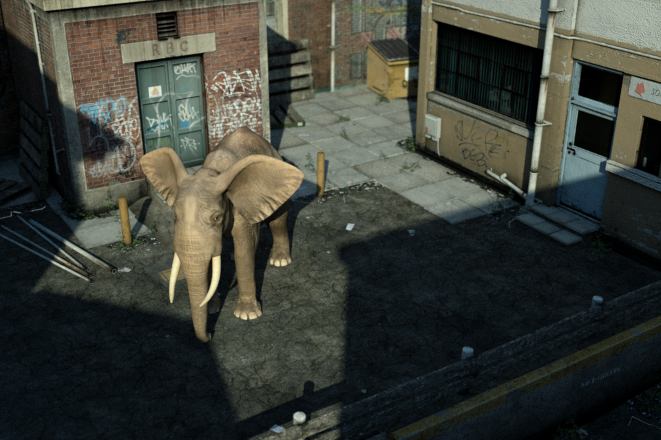

some output tests;
stonemason's "dark side of the city" plus the daz elephant;
loaded, rendered with defaults and pmc, 1.5mins total (loading, clicking the button, waiting & watching ;)

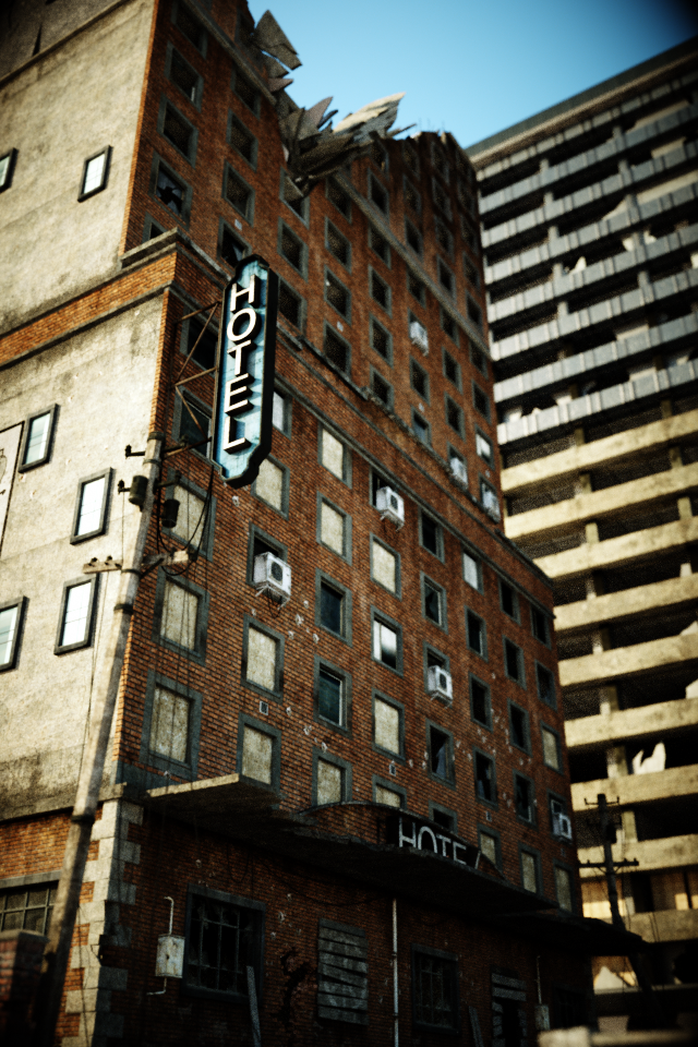

again stonemason and a bunch of his city ruins,
material defaults, as created by the plugin, plus some imager settings; 1.5min render time with pmc:

some numbers about the city ruins images:
  • 204 daz materials,
  • a total of 148 textures
  • used 230 times
after conversion & optimization:
  • the number of textures was reduced to the maximum of 96
  • and these were used 116 times
  • within 129 created octane materials
vram usage was a little above 300mb...
