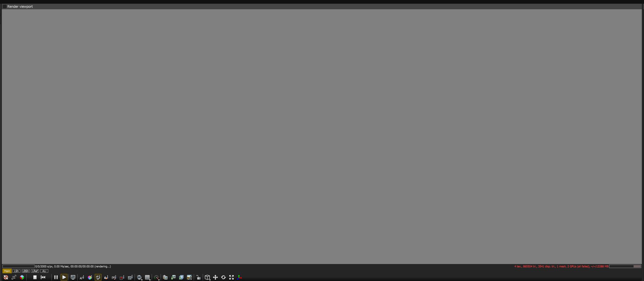

Jasonr
Posts: 97
Joined: Tue Aug 02, 2016 2:08 pm
Hi Paul.
I have tested it already and it seems that the problem persists.
I cannot find the log in the standalone to upload the error.
GPU Fail
GPU Fail
