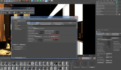

No, secondary is "HD cache"glimpse wrote:I though Corona is BRUTE FORCE..so, this given scene, how it was made to render?aoktar wrote:
Hey,
Common pitfall is to compare the different concept. BRUTE FORCE against to GI CACHE estimations. Corona has two modes as i could see. I think it's impossible to hit GPU rendering by BRUTE FORCE methods. And i'm very curious about results of GI cache on animated meshes. Vray had this problems(GI filickering) on GI estimation methods.
need to do more homework, as it's not fair to compare apples to oranges then..
Interior rendering tests
ok, so it means they are cutting corners =) curious to see if there are any downsides in animations then..aoktar wrote:No, secondary is "HD cache"
& I guess it is possible to make brute force on both, primary & secondary solvers, isn't it?
yes, you can select "path tracing" as secondary. I think it's brute. I have started a render with this option but i have to cancel after a half hour. That was too noisy still and was looking as Octane's after first minute.glimpse wrote:ok, so it means they are cutting corners =) curious to see if there are any downsides in animations then..aoktar wrote:No, secondary is "HD cache"
that doesn't surprise at all, remember doing that in vray..- in any interior that's simply not an option..aoktar wrote:
