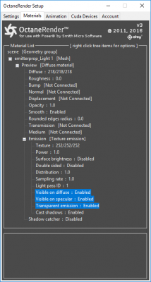

In the latest version, you also have a bit more flexibility, due to the newly implemented options.
A more in-depth explanation can be found here: viewtopic.php?f=33&t=62395 "New emitter options "Visible on diffuse", "Visible on specular", "Cast shadows" :D
