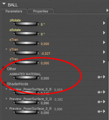

this is a example poser project.
test it with octane render
try to move the parameter from 0 to 1 and viceversa
with octane no refresh animated value

- AM.jpg (53.12 KiB) Viewed 3942 times

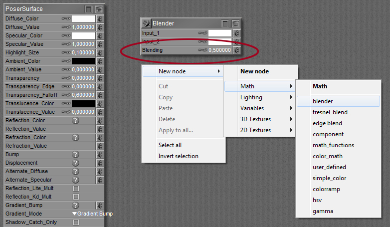

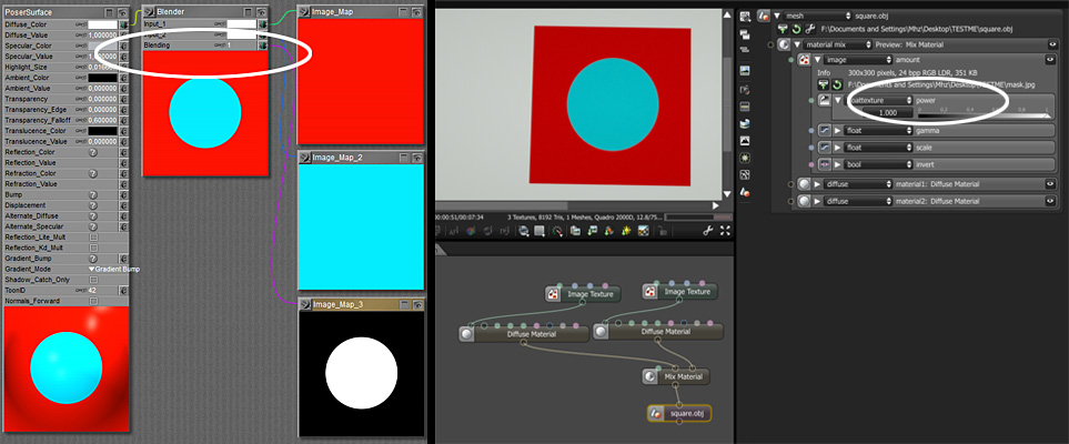

hmm, It seems complex, we must find a way to convert the data sooner or later without overburdening of octane .., for now I would only load values Blending in Blender node with 2 texture loaded in imput_1 and input_2 and mask image in Blending.
anyway yes ..is need to have a animate materials (AniMat) tab
and support for poser master parameter animation.

I want only (for now) to have a feedback with octane about animation value of blender node
is it possible?
But if you can give feedback with all animation value of materials its good!
is it possible?
There is no support for the Poser "blend" node currently within the plugin (ie. the "blend" node does not automatically convert to an Octane "mix" node), so building in animation support for it is not viable (I cannot add animation support for something that is not currently implemented).
