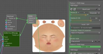

I don't know how it's with that character, but Kallisto has a separate blush texture. You can save the PNG as PSD (PNG won't work for some reason) and add it via multiply to the basic face texture. You can adjust the strength with gamma.

As you've already found out, the current solution is to manually insert the make-up overlay via a Multiply, or better, a Mix Material node.
