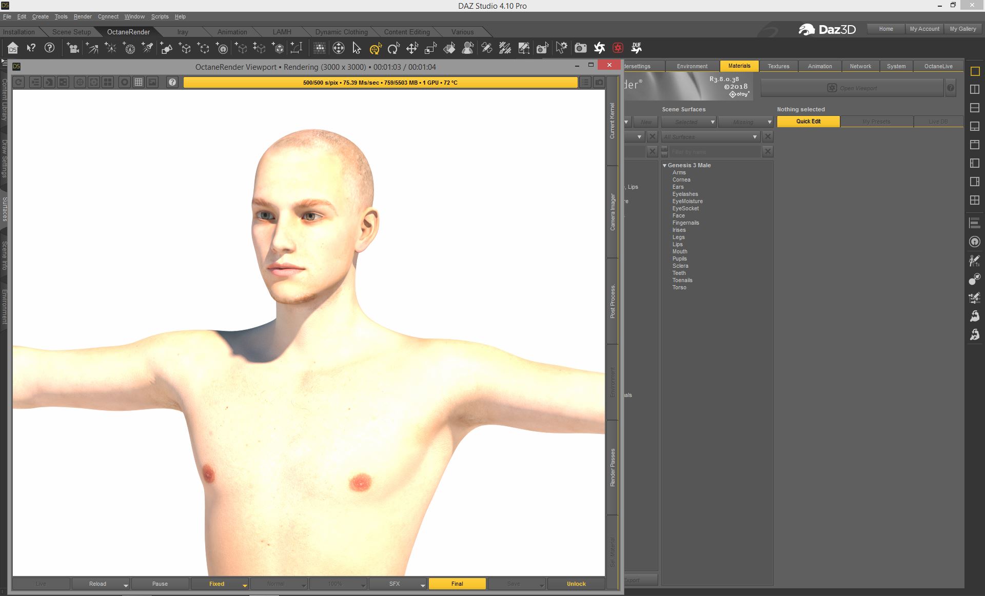

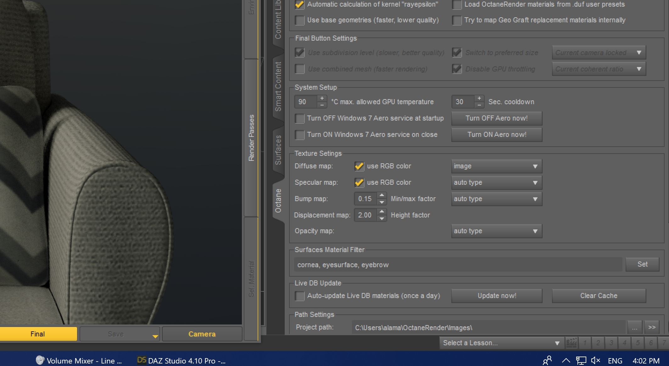

To recreate the error
go to render setting and choose a render size larger than view port size, example 3000 x 3000
make sure switch to preferred size is clicked and current camera locked is selected.
click on final, once render is complete the save is grayed out except for a small triangle (yellow)
if there is an other way to save an image that's larger than my view port size please let me know.

Well, a simple primitive isn't enough content in the scene to raise the issue.
I was able to reproduce this with a Genesis 3 figure:
G3 Male, settings as in the post above
Win11/64Bit | GTX 4090 24GB | NVidia Driver 546.29 | Octane 4.05 | DAZ Studio 4.21

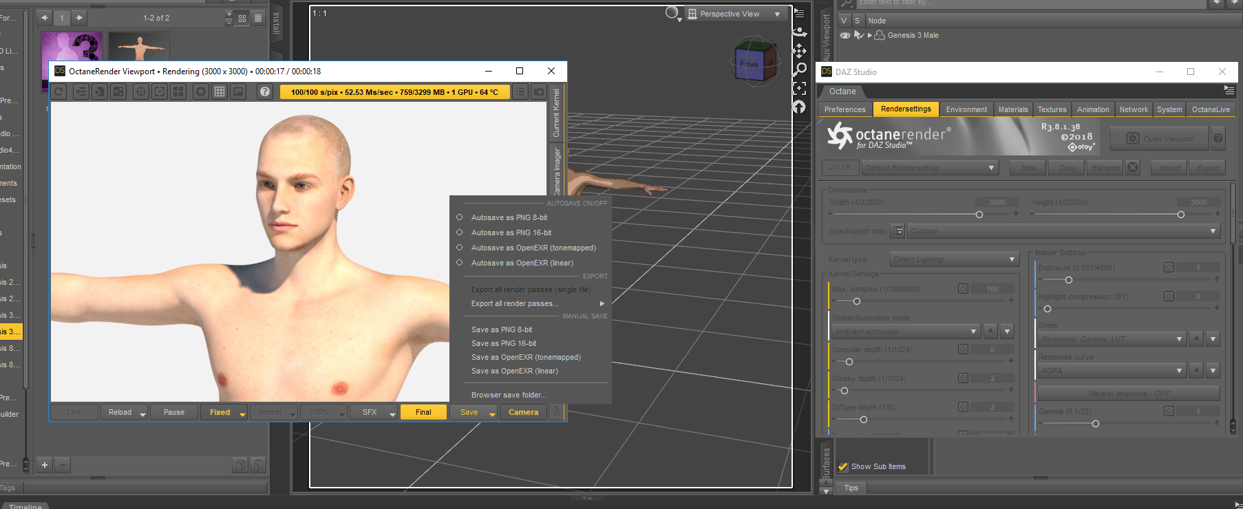

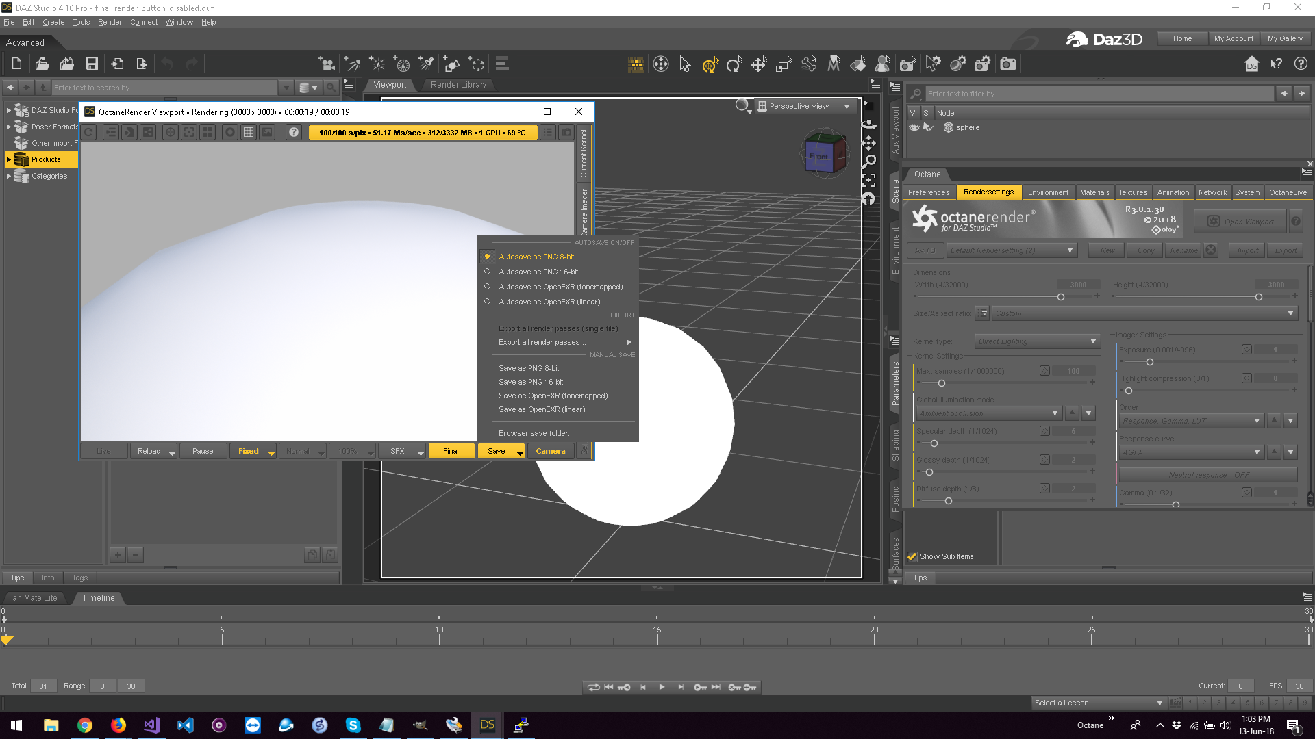

I think i'm getting better at understanding this problem.
I'm thinking it's memory related because.
1) if i render a simple cube say dimensions 5000 x 5000 the save button appears. I rendered it 10 times in a row and it worked.
2) I load Victoria 8 fully textured but no hair, try to render the same scene... it works... i have a save button. I save file and repeat the process, the second time it will not work, save button is grayed out.
I have a 1080ti and i pushed the out of core memory to the max. I'm on windows 10 latest release.
not sure if this helps you, but I really would like this to work. if you can't reproduce it, would it be possible just to delete the code that greys out the save button? for some reason it ends up going to that subroutine.
