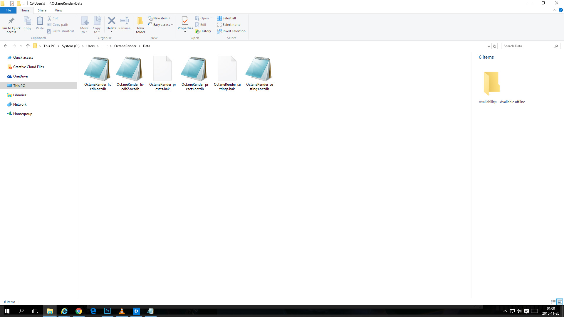

Maybe that is part of the issue:
OctaneRender_switches.cfg file was not created by the OctaneRender_for_DazStudio_2_24_2_1_Win64 installer

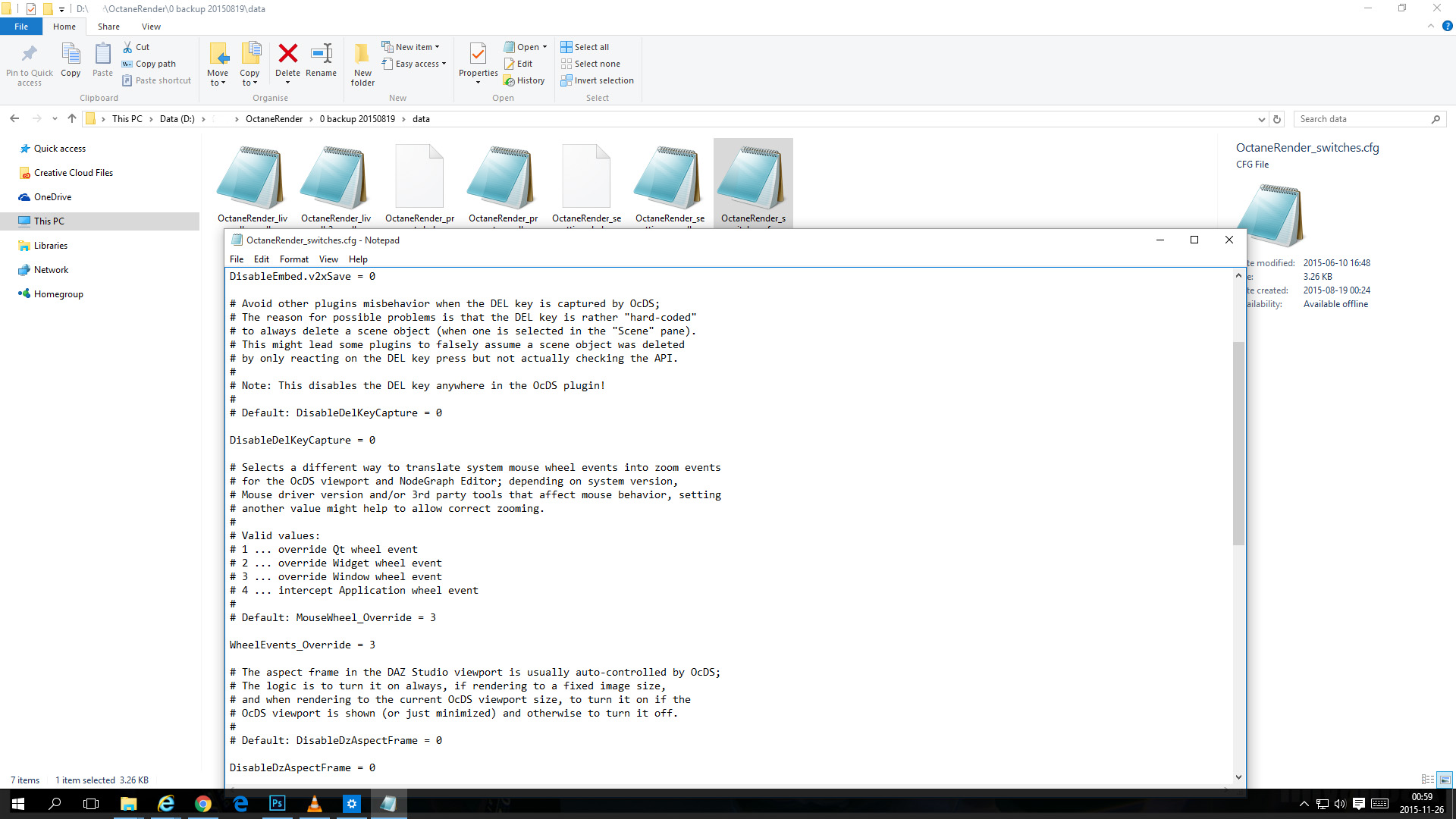

I nevertheless did find a backup copy of that file:
I will not try for now to copy over that backup of the OctaneRender_switches.cfg file in order not to make things potentially worse...
