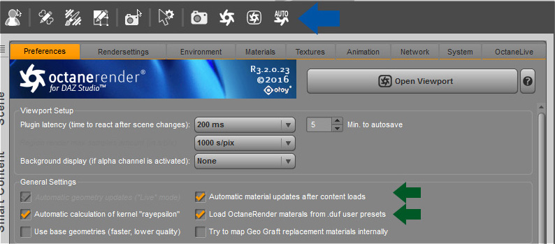

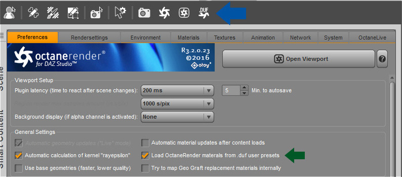

Which setting is controlling if DAZ Studio materials are loaded automatically and converted to OctaneRender materials?
In the OctaneRender plugin for DS Preferences Tab you find the option
"Automatic material updates after content loads"
If you remove this checkmark only the geometry and no textures are loaded when you open the OCDS viewport.
- When you open the OCDS viewport all the geometry will be displayed in a default gray material.
- This also means that whenever you change DAZ Studio materials those texture changes will not automatically be updated in the OCDS viewport. :!:
- If you change DAZ Studio materials while working on the scene you will need to reload them manually each time with any method explained below.

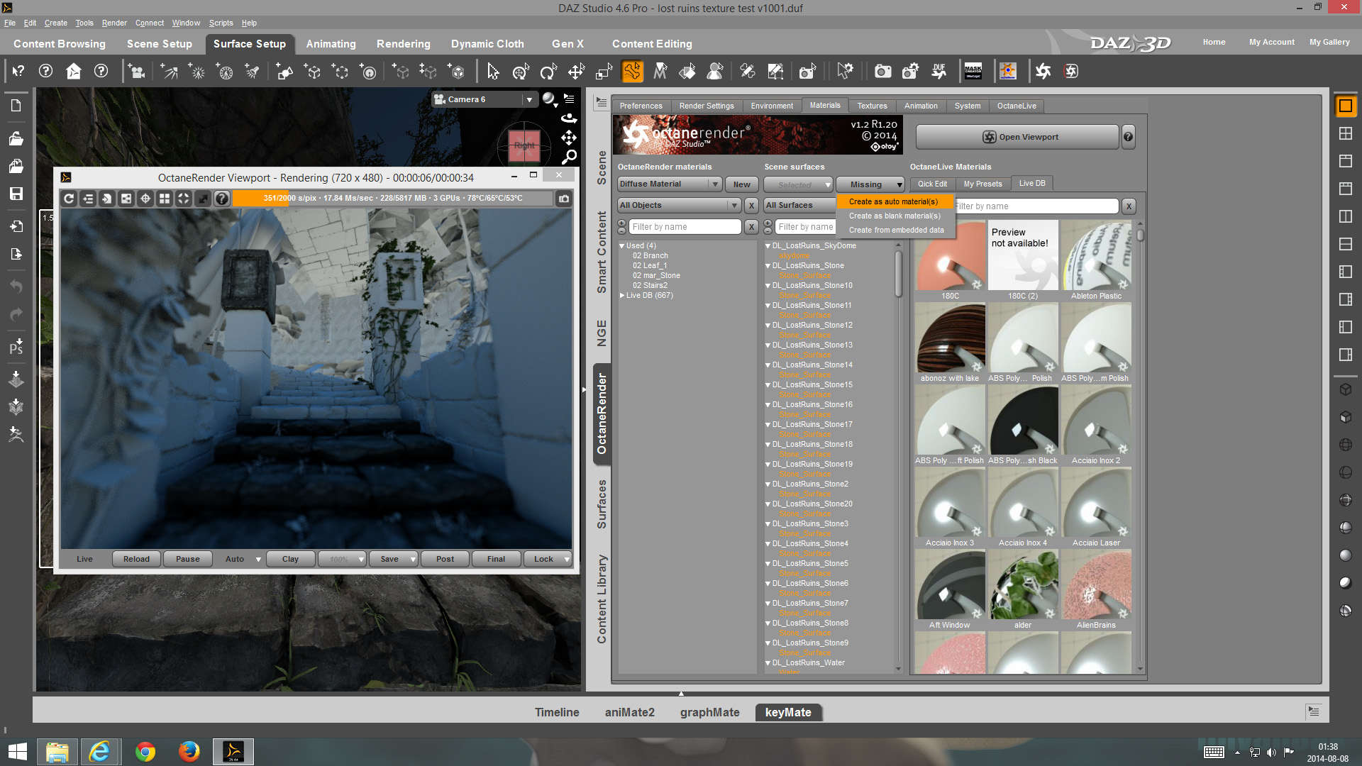

In the OCDS material tab right click on any surface and select "Create as new material - Auto Material" to reload the DS materials for that surface.
To manually load any DAZ materials of a surface and convert them into OctaneRender materials all you have to do is to right click on the surface and select
"Create as new material - Auto Material".

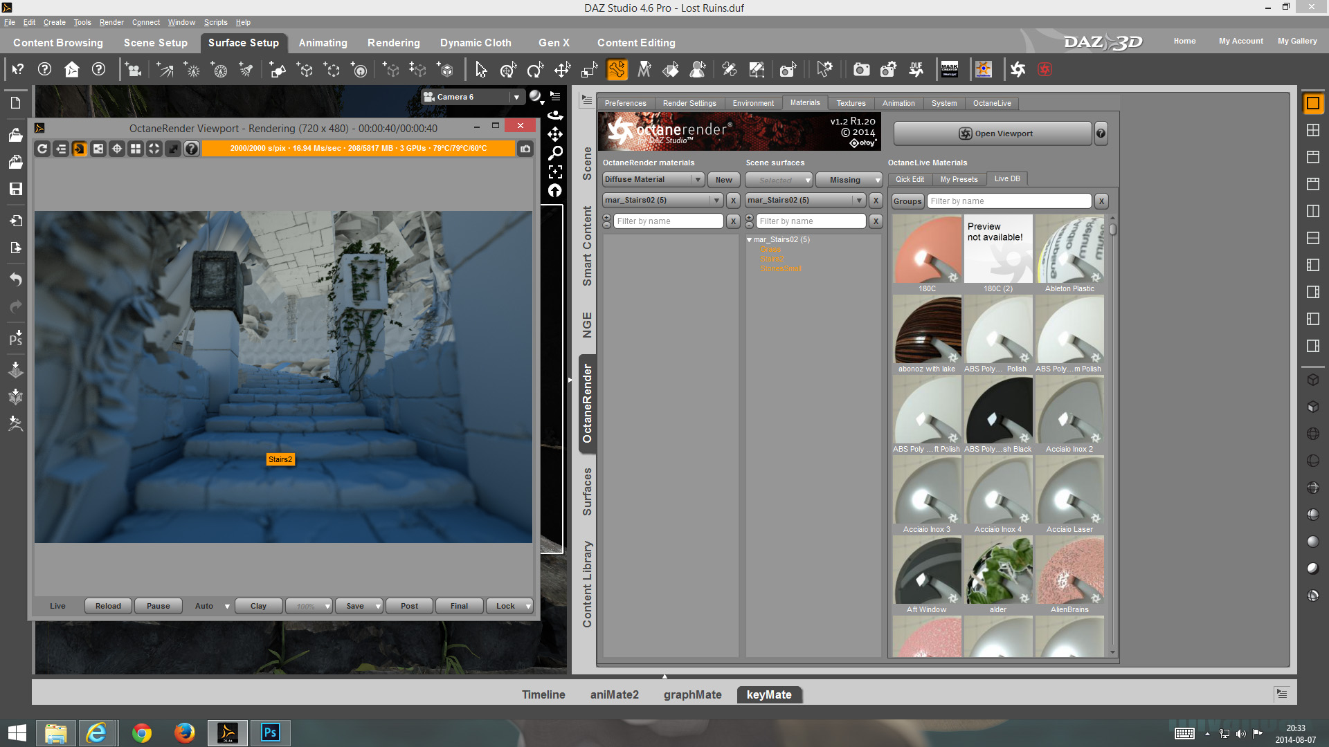

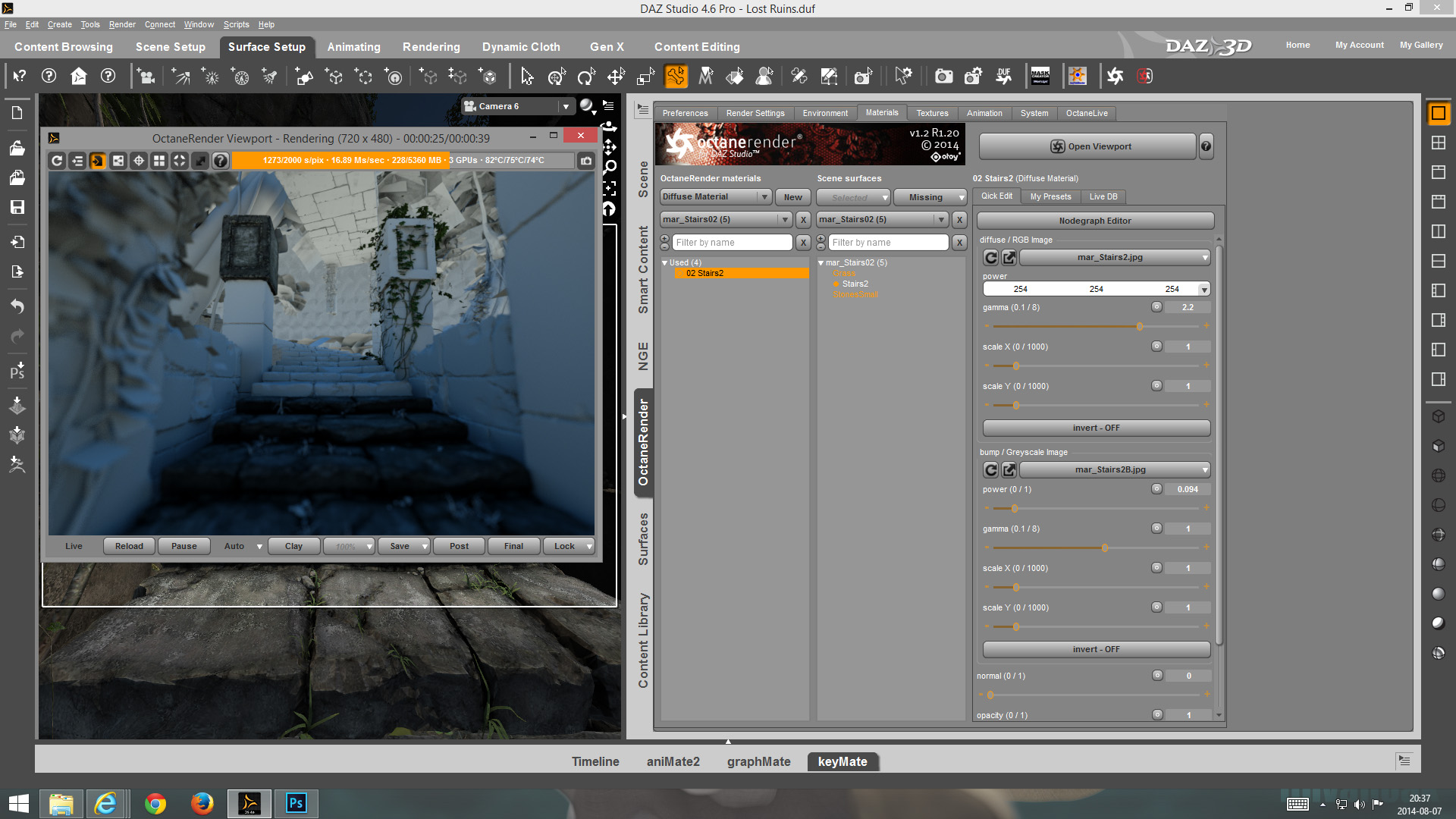

If the conversion is successful you can immediately see the change in the OctaneRender for DS plugin viewport.
The surface Stairs2 is written in white in the Materials Tab Scene surface list to indicate that a material is now assigned to that surface.
Grass and StonesSmall are still written in orange because those surfaces have not yet an OctaneRender material assigned to them.

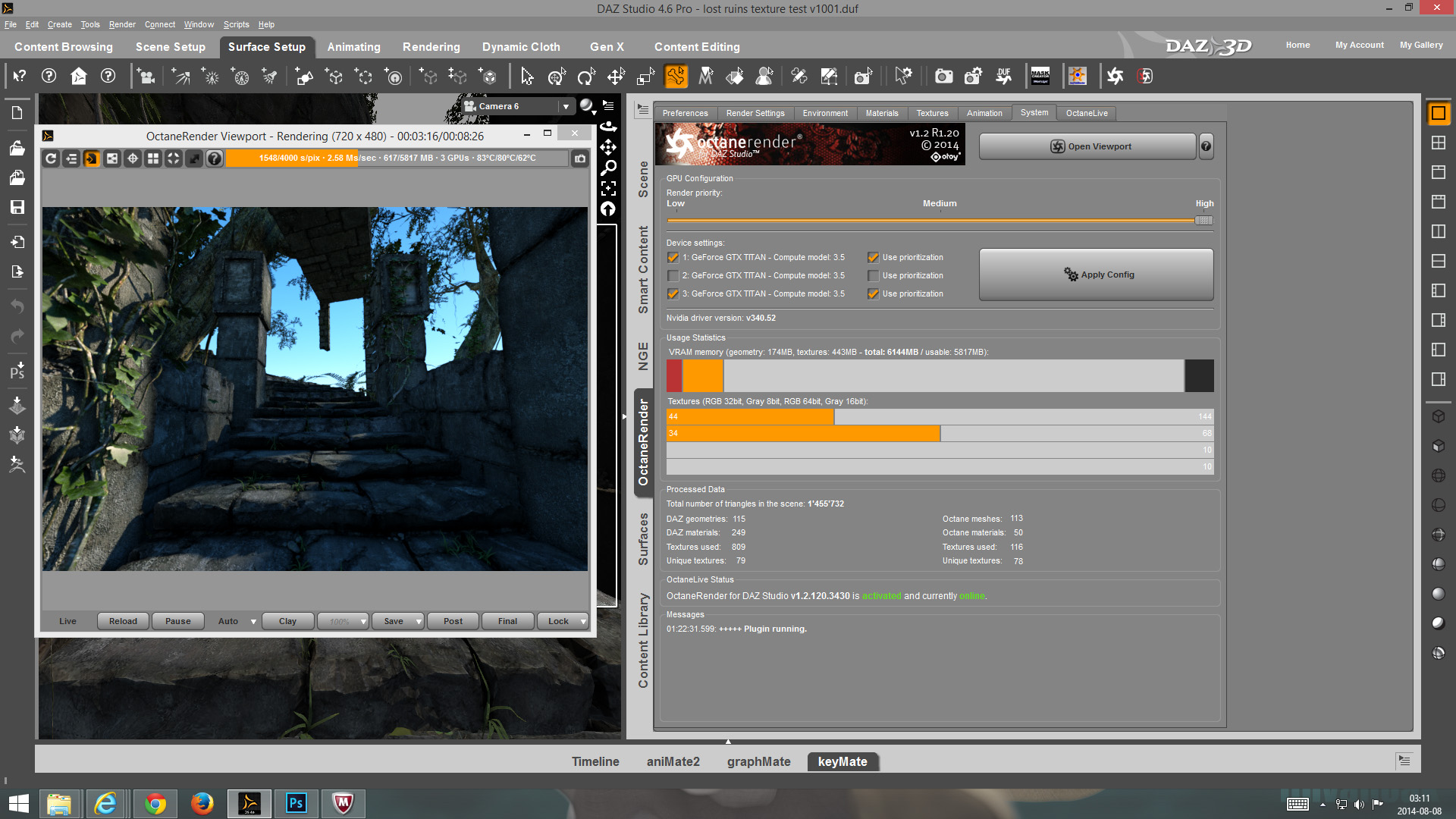

Use the OCDS System tab to get information about available VRAM space
In general while loading textures it may help to have a quick look at the available VRAM space in the OCDS system tab.

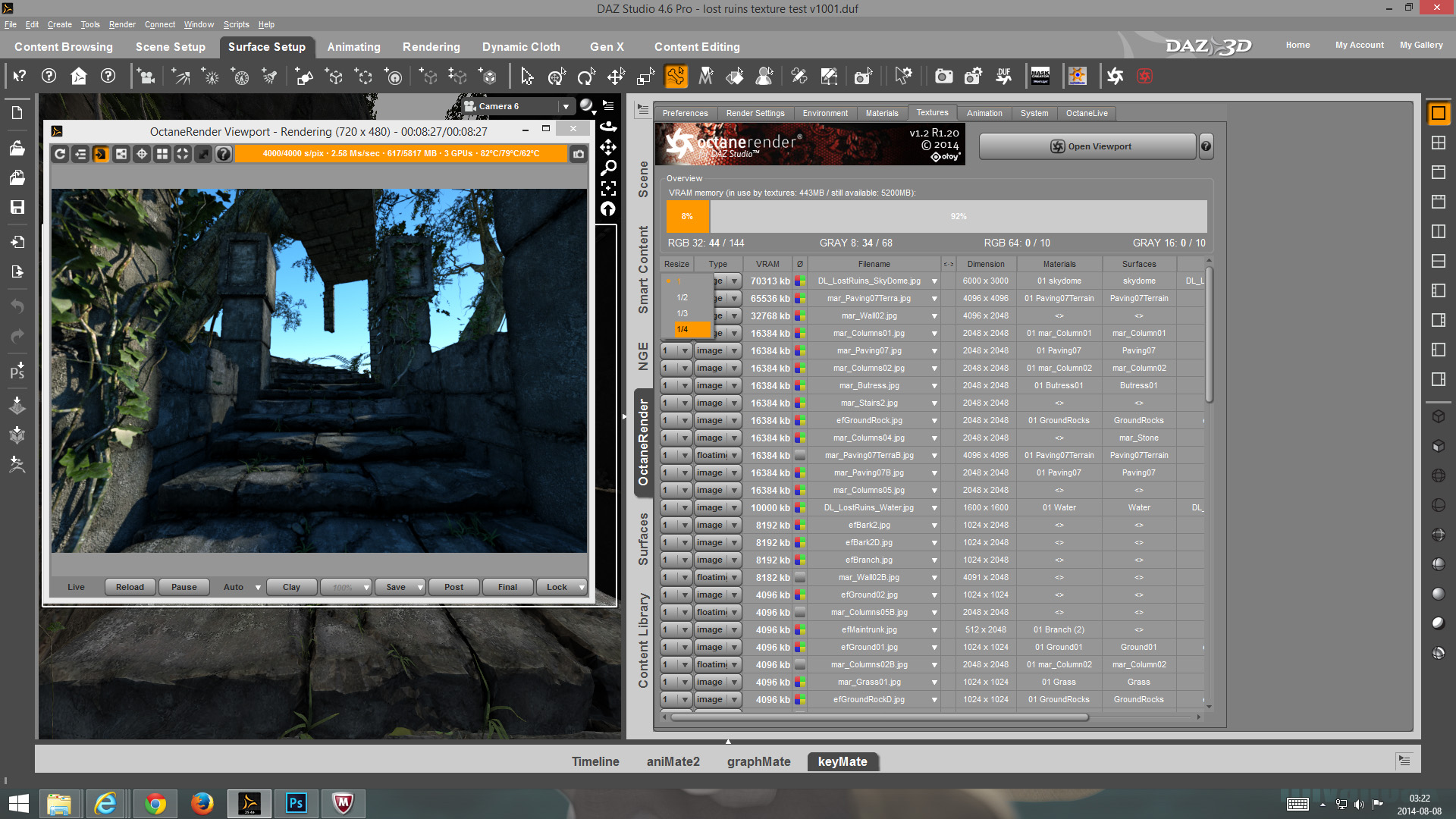

In the OCDS textures tab you can resize any textures to 1/2, 1/3, or 1/4 of their original size.
One of the most overlooked features may be to actually lower the size of the textures directly inside the OCDS texture tab. The feature may be hidden away on first glance.
Clicking on the first column "resize" in the OCDS textures tab will open a pulldown menu.
The texture can be resized to 1/2, 1/3 or 1/4 and will take less space in the VRAM.
The original texture size is not lost and can be quickly restored by selecting the default size of 1 again.
Use the resize function on the OCDS textures tab to lower the amount of VRAM used.jpg

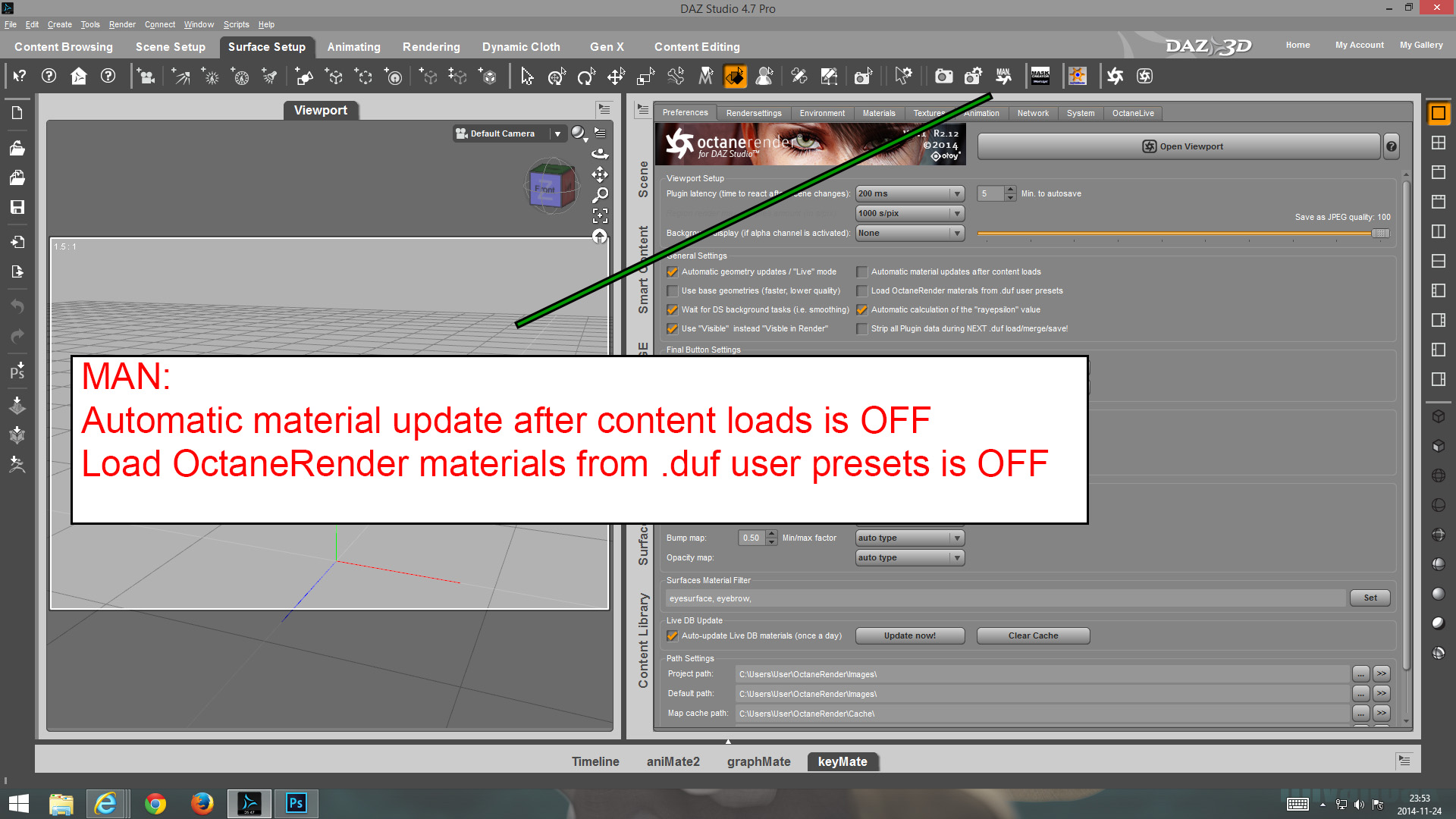

Postby Spectralis » Sun Nov 23, 2014 9:25 pm
Spectralis Sun Nov 23, 2014 9:25 pm
I'm having problems with loading scenes I created on my old PC on my new PC. The "automatic material updates after content loads" is switched "OFF" on the new PC but the scene loads with all of its materials.
I really don't want this to happen and it never happened on the old PC. Every time I loaded a scene I was working on I had to manually auto load the materials which suited me fine. Now they load automatically.
I have DAZ 4.7 and OR 1.2 on both machines witrh duplicate content folders.
Do I need to switch off "Load Octane materials from .duf user presets" as well?

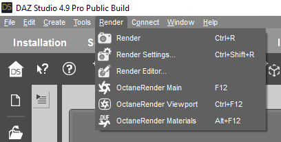

Postby sikotik13 » Sun Nov 23, 2014 9:39 pm
sikotik13 Sun Nov 23, 2014 9:39 pm
Assuming you don't have the icons on your main bar, you can go to Render>OctaneRender Materials and set that to manual. Should load only the geometry. If you do have the icons, just click the Octane one with auto or .duf over it until it says man. if that doesn't work, I'm not sure what's wrong, since that's how I troubleshoot mats that causes crashes, and it always functions correctly for me, regardless of what the system tab says.
Edit: I clearly don't pay enough attention to the preferences tab, as all that changes is also unchecking the box for "Load Octane materials from .duf user presets." Apparently, this setting loads mats saved with the .duf, even if auto loading is off. I presume this means that auto is only for conversion of mats, and doesn't apply to saved mats. Sorry if you already tried this and I missed it.

Postby sikotik13 » Mon Nov 24, 2014 10:36 pm
sikotik13 Mon Nov 24, 2014 10:36 pm
As I explained in the edit on that post, it's just a less buried toggle for the options in the preference tab, specifically, it unchecks the "load materials from .duf files" and unchecks the auto generate/convert materials boxes. If unchecking those boxes manually is not fixing your error, the equivalent to a shortcut to perform that same operation will likely do you no good.

AUTO
"Automatic material updates when content loads" - ON
"Load OctaneRender materials from .duf user presets" - ON
This is a useful setting if you do want to fully rely on the material auto conversion of the plugin and have enough VRAM to handle even large scenes.
In auto mode any Iray or 3Delight DAZ Studio materials are converted the moment you load a new object into the scene.
DUF
"Automatic material updates when content loads" - OFF
This setting is useful if you have limited VRAM and want to only load the geometry of new objects added to the scene.
The basic idea is to manually load the materials of one scene object after the other with the help of the tools described on the first page of this thread.
Scenes with objects that already have OctaneRender materials set up do load with the materials.
MAN
This setting is useful when you want to make sure that all objects that are loaded will only include the geometry even if you created some custom OctaneRender materials before.
There is no automatic loading and converting of materials at all.
When loading scene objects that already had some OctaneRender materials set up the materials will not be loaded.

- In the OctaneRender plugin for DAZ Studio preferences tab you can add and remove checkmarks for "Automatic material updates when content loads" and "Load OctaneRender materials from .duf user presets" manually.
- In the DAZ Studio user interface tool bar the current state should be displayed as a button that switches between the three stages when clicked.
The button is only displayed when the tool bar "Viewport tools" is toggled on for the current activity in the "Customize DAZ Studio" window. F3.

- In the DAZ Studio user interface "Render" main menu the option to switch between the three states can be found as action called "OctaneRender materials".
