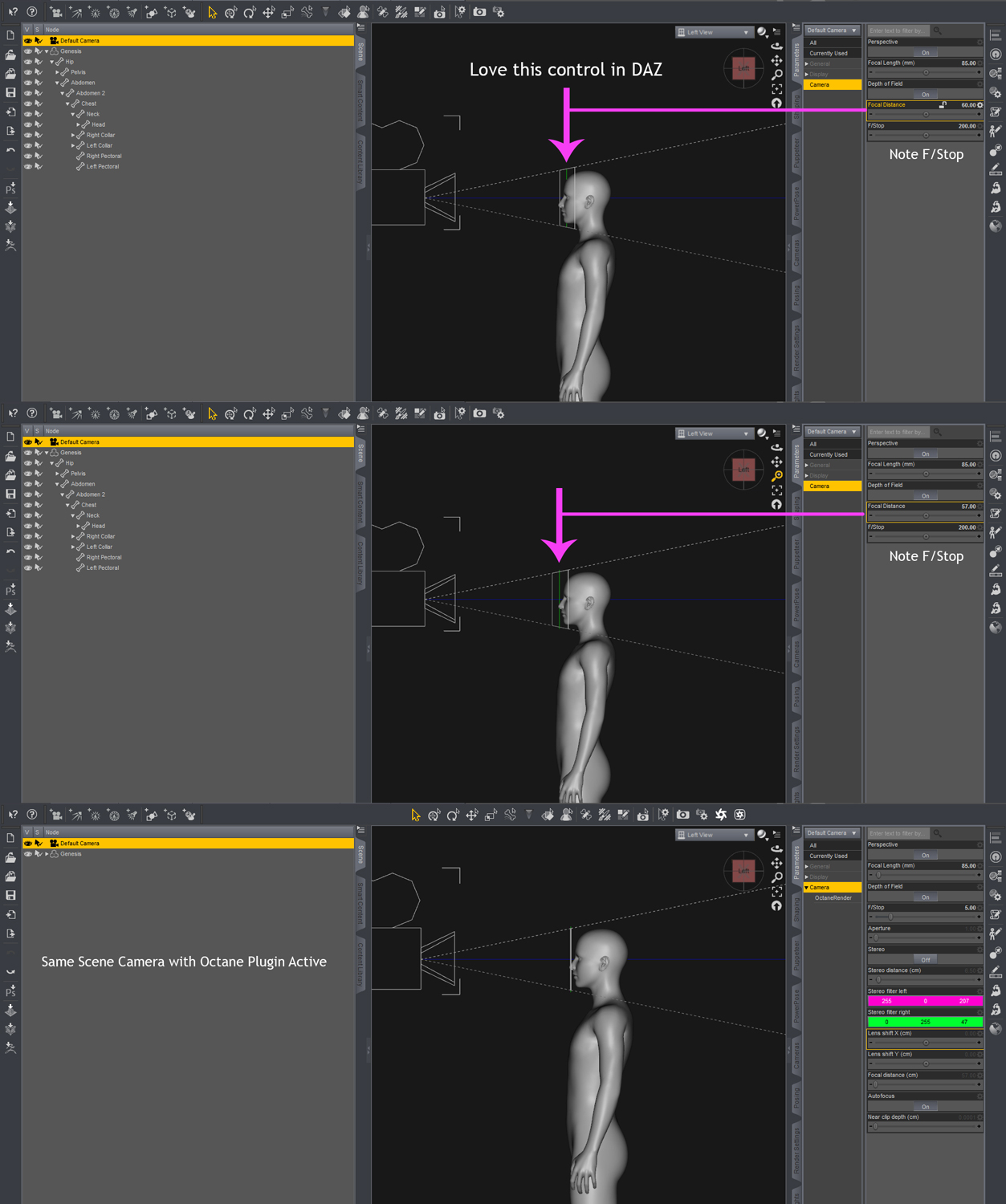

I really do like the Focal Control DAZ Cameras can give me.
Please see attached and link below to image.

t_3
Posts: 2871
i admit, focal distance control is too much centered to octane when using the plugin. but this should be possible to change. i will need some time to find a practial solution to get this done with all the different focus modes the plugin provides.
f/stop on the other hand has no practical solution - at least if daz f/stop and octane aperture should be connected.
imo they should be, because they mean the same thing only by different parameters.
but if you need to set a f/stop of 200 to get nice dof with 3delight, they might better be not connected, because this number is totally weird and way off from anything in real world camera operating ;)
my thinking was, that the f/stop parameter is in general easier to use for people, since it's outcome is known from real world experience, whereas the "aperture" value in octane is something pretty abstract. thus i decided to put them together.
so the maybe best solution would be to let alone daz f/stop, and provide another f/stop slider for octane, which does internally calculate the aperture from it - what do you think?

I think I got a little turned round over the focal length as the camera settings get a little altered by Octane with the actual parameter I was thinking of (Focal distance) being hived off to sit under the OctaneRender sub-parameters.
So far as I know the f-stop parameter native to DS cameras bears no resemblance to real life, so I suspect as you mention leaving that alone and only affecting DS would be a good idea. Mind you, that then means a similar-named, un-linked, parameter specific to Octane ... hmmm, thorny issue! Could you 'take a stab' at conversion as/when DoF is set on, or having a 'Convert f-stop' button? How you'd convert'd be a bit of a stab in the dark, but I presume it'd be possible to do with ranges, setting the 'real' f-stop to Octane minimum when DS < 1, to Octane max when > 100 and suitable dealing with the in-bewteen bits? ;)

it's because this is actually the octane focal distance slider, and the one of the daz camera gets hidden. now i also know why i did this. it is just one of a myriad of tiny problems doing this integration: daz studio alters the focal distance all the time under specific circumstances if you move the camera. and it doesn't do it in a senseful way, since it seems to always use a non-user-controllable camera target to calculate the focal distance. from my experiance, especially if watching the outcome live in the octane viewport (what you will never see rendering stills in 3delight), it looks plain erratic. in the end i decided to completely grab control of this parameter, add focus to and focus follow modes, to make best out of what is there.
what imo would be needed to basically leave it this way, but make it work better:
- more comfortable slider range settings; the current range doesn't allow any fine tuning by moving the slider ;)
- mapping back the octane focal distance to the daz camera, actually oversteering it; this way you will...
- - be able to control it via the visible focal plane again
- - have it in sync in octane and for 3deligth (or others ;))
- - be able to still use octane autofocus, focus to and focus follow modes
SimonJM wrote:So far as I know the f-stop parameter native to DS cameras bears no resemblance to real life, so I suspect as you mention leaving that alone and only affecting DS would be a good idea. Mind you, that then means a similar-named, un-linked, parameter specific to Octane ... hmmm, thorny issue! Could you 'take a stab' at conversion as/when DoF is set on, or having a 'Convert f-stop' button? How you'd convert'd be a bit of a stab in the dark, but I presume it'd be possible to do with ranges, setting the 'real' f-stop to Octane minimum when DS < 1, to Octane max when > 100 and suitable dealing with the in-bewteen bits? ;)
