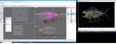

sun below horizon
sun below horizon

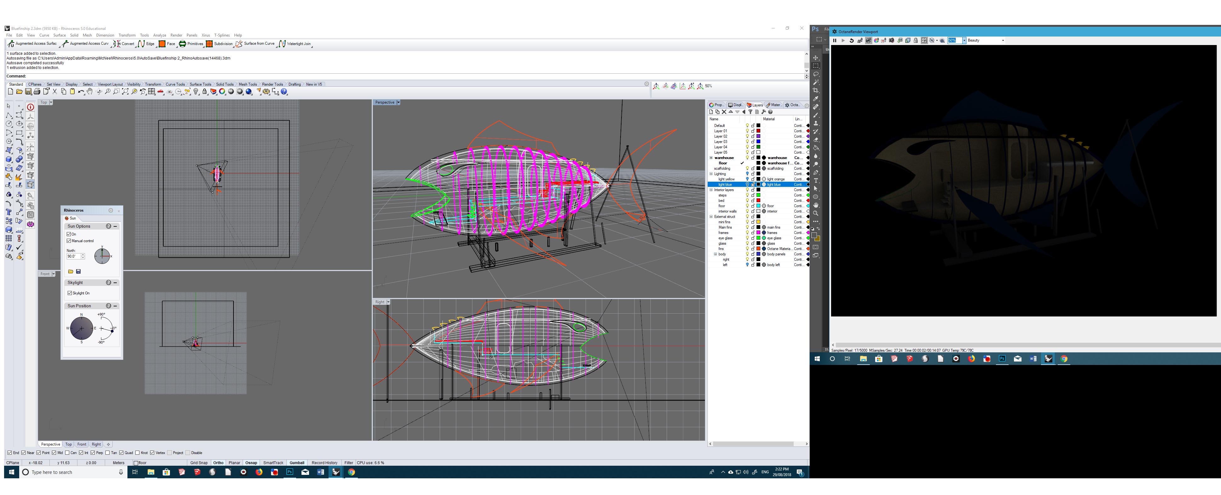

sun on lights off
sun on lights off

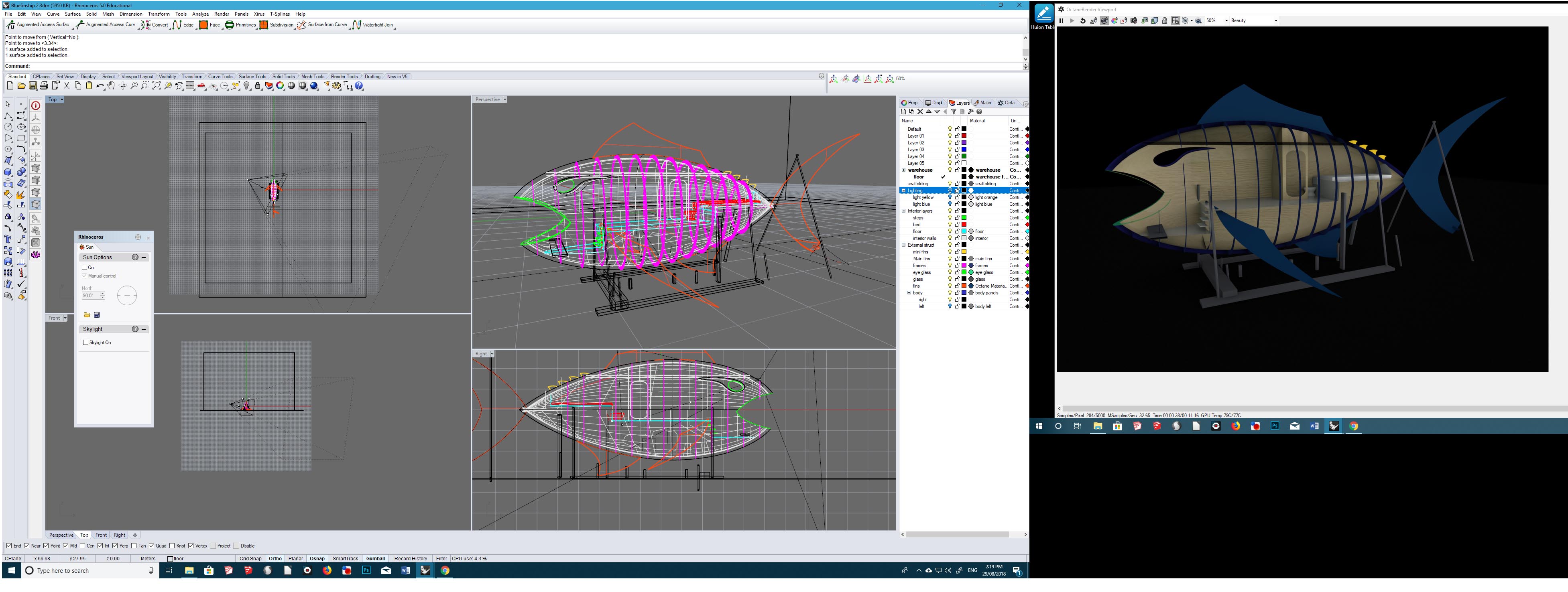

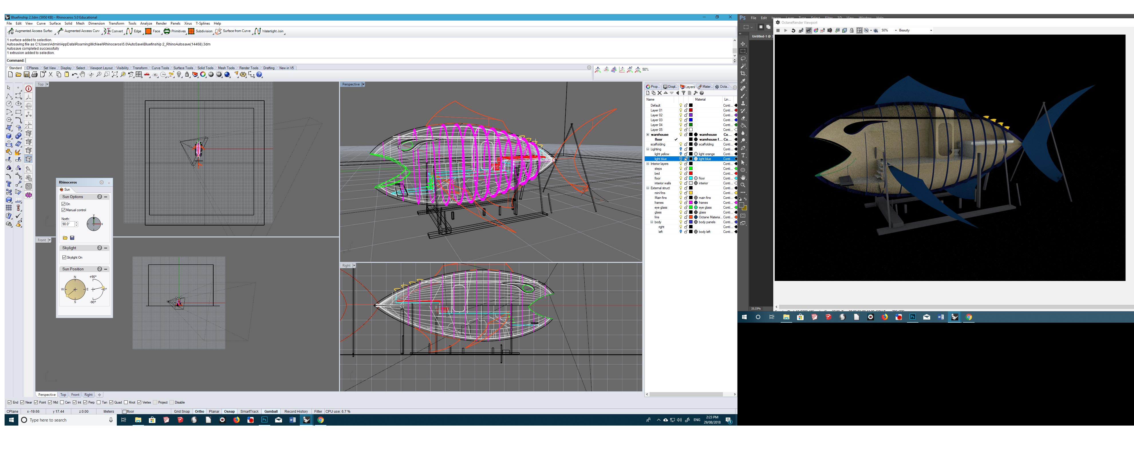

sun off and lights off

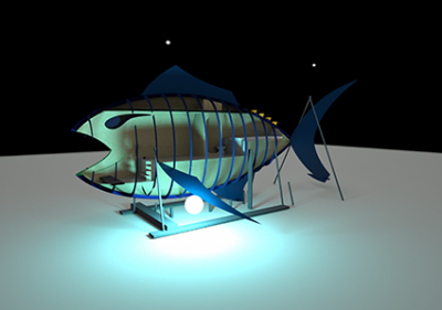

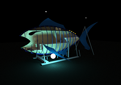

darker floor
darker floor
Also, when i turn on some lights that are not overly powerful, it has a strange effect.
If the warehouse floor is a light colour, the floow lights up all the waty to the back of the room which is shouldnt do with only those lights.
if i turn the floor a darker colour, the whole room goes dark which is to be expected.
lighter floor shouldnt light all the way to back?
