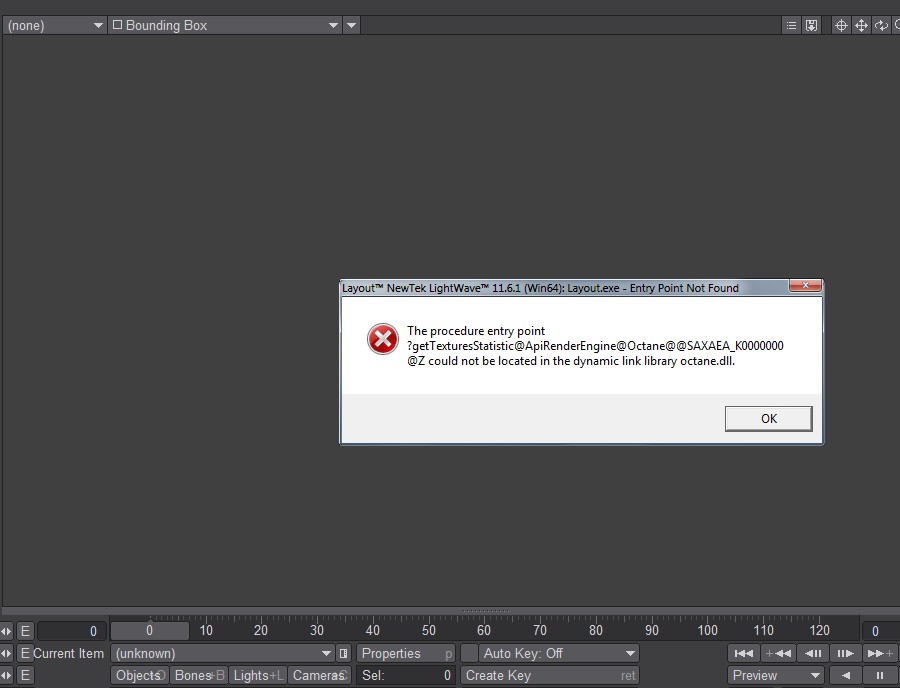

Wonder what is this error? I didn't get this when testing the demo. Now its there when starting up lightwave for the first time. Its gone after closing layout and launching again.
juanjgon
Posts: 8867
Location: Spain
geo_n wrote:Wonder what is this error? I didn't get this when testing the demo. Now its there when starting up lightwave for the first time. Its gone after closing layout and launching again.
I think that you are mixing the Octane.dll and Octane.dat files from one version and the .p plugin file of other version. Please, download the .zip file again and be sure that you have the .dll/.dat files in your LW/bin folder and the .p file all from the same .zip file.
-Juanjo

Double checked. I think its caused by using intel hd 4000 for display while my puny nvidia card is assigned for rendering. Anyway its no biggie.

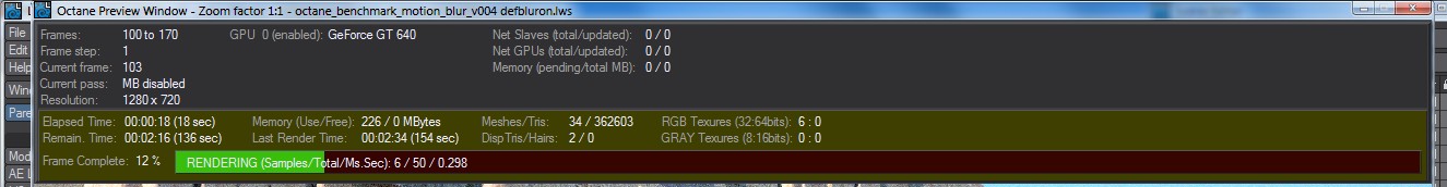

Is mdd motionblur supported? Does it need to be world space? I have an mdd mesh parented to a null but its not getting any motionblur in F10.
juanjgon
Posts: 8867
Location: Spain
Do you have the deformations motion blur enabled in the render target root node options?
-Juanjo

Yep it was off. Any reason why this is off by default?
Also when I turned it on why is the render status saying MB disabled?
