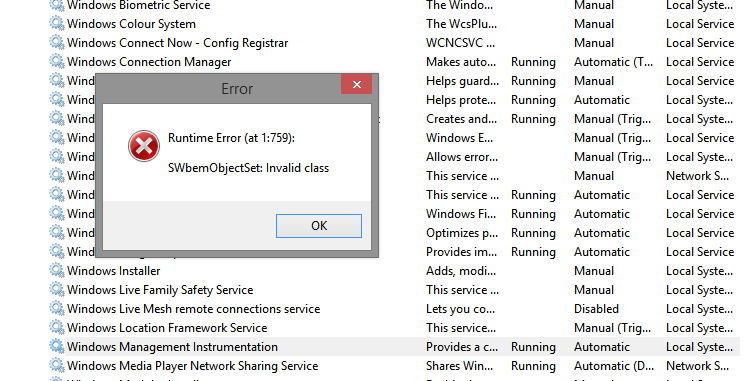

I'm getting an error when trying to install the plugin. It says: Runtime Error (at 1:759): SWbemObjectSet: Invalid class.

Hi - this is the process that checks if Modo (or Poser) is already running. I have not seen this error occur before - what operating system are you using pls?
EDIT: I found a Microsoft page on this. It implies the WMI libraries have not been installed on your system. You can install these via....

I would have thought it very hard to not have WMI installed. Have you checked if the WMI service is running? Control Panel->System and Security->Administrative Tools->Services->"Windows Management Instrumentation" - it should be Running and Automatic. If not, start it and install the plugin.

It seems to be running, but I still get the error

After researching this a little further....for Win 8.1 it appears to be a mandatory component - not options - so it should be on your system. However seeing quite a few posts with ppl having WMI issues - so it looks like WMI breaks in rare situtations.
The following link details how to troubleshoot WMI installation issues: http://kb.paessler.com/en/topic/3713-i- ... ng-windows. A lot of the solutions do not seem applicable in your case - however "The rebuild Windows system files option" and "The refresh performance counters option" would be worth trying.
The installer uses WMI to make sure Modo.exe is not currently running - so it is an important part of the install process.
The following link is for the Modo installer with the WMI check removed - that will at least get you up and running.
http://render.otoy.com/customerdownload ... NO_WMI.exe
Paul

Also, what is the result of running a Command Prompt (Admin) and typing:
Code: Select all
winmgmt  /salvagerepository

Thanks, I managed to fix it. Eventhough winmgmt /salvagerepository returned "WMI repository is consistent" I still got the error. winmgmt /resetrepository finally did the trick. I had to stop all the WMI related services. After a reboot I managed to install the plugins. Thanks!
