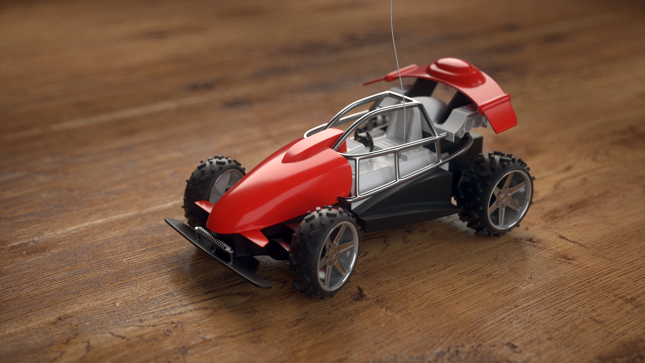

I've done test render with new plugin version.
Win 8.1/64 | Geforce GTX780TI | Core I7 970 | 24GB
