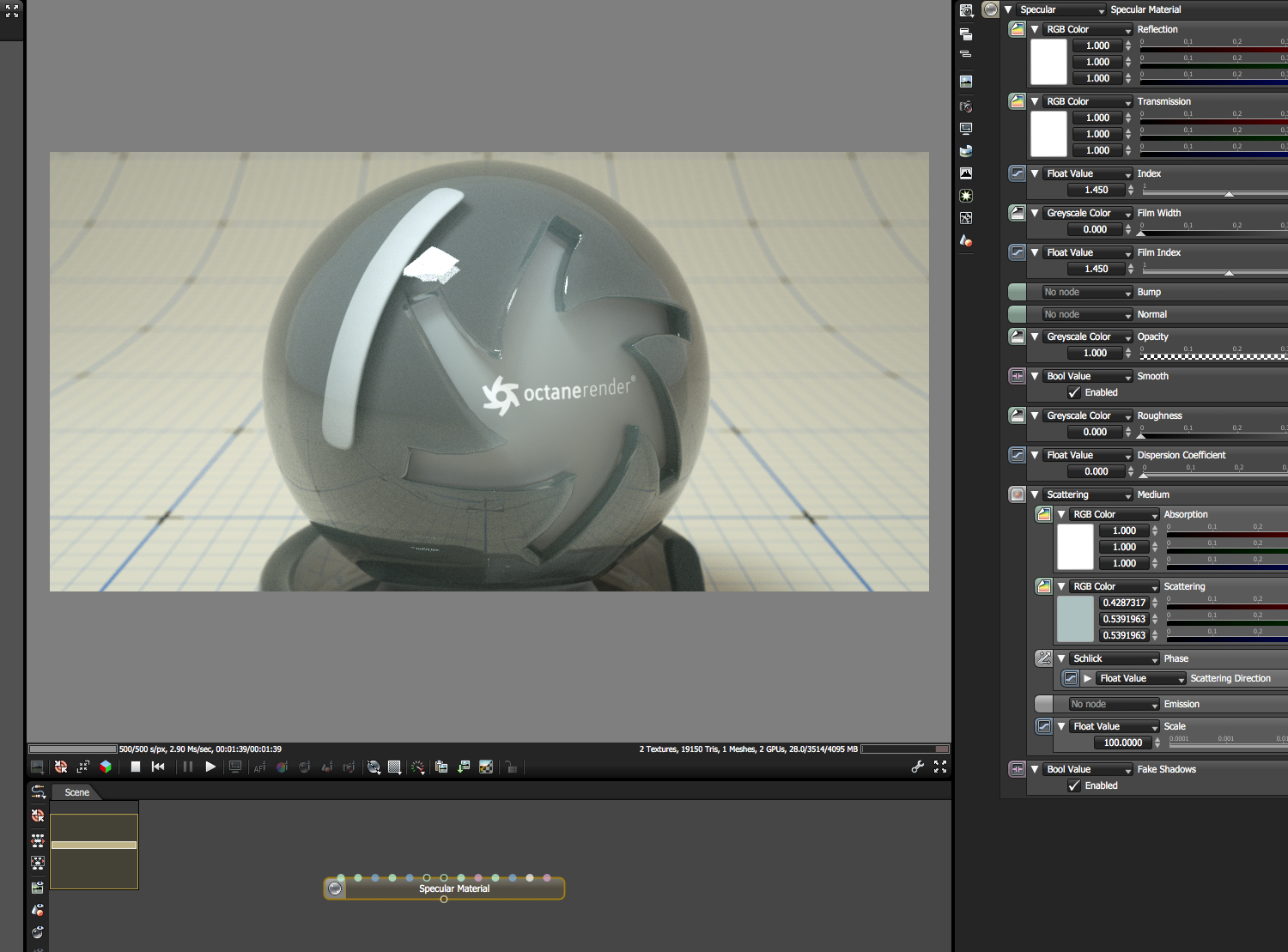

And the roughness value seems to affect both refraction and reflection. What if I want a frosty material with glossy reflections?

Obizzz wrote:And the roughness value seems to affect both refraction and reflection. What if I want a frosty material with glossy reflections?
Martin, I think in that case you would want to use the Scattering medium in the Spec material. Basically like adding SSS in MODO. That way you could keep the roughness down.
Like this:
Glossy and frosty :)
