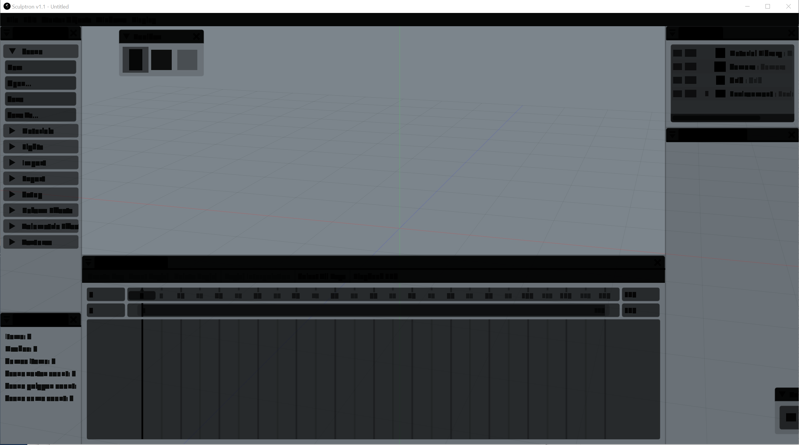

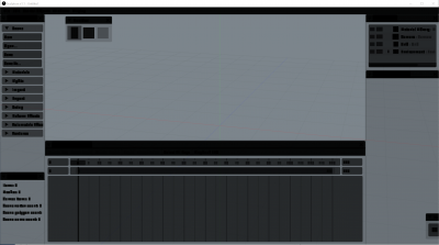

Note on previous post.. Sculptron 1.12 loads but menus are all unreadable

And also 1.12 loads but all text is unreadable - Windows scaling is at 150% here (and needs to be)
