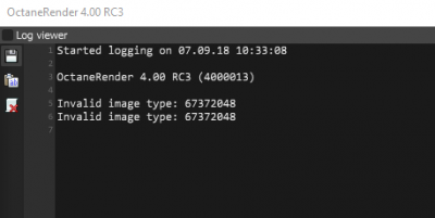

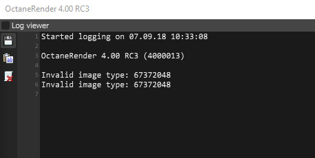

This error shows up in the log when starting Octane:
Started logging on 07.09.18 10:09:29
OctaneRender 4.00 RC3 (4000013)
Invalid image type: 67372048

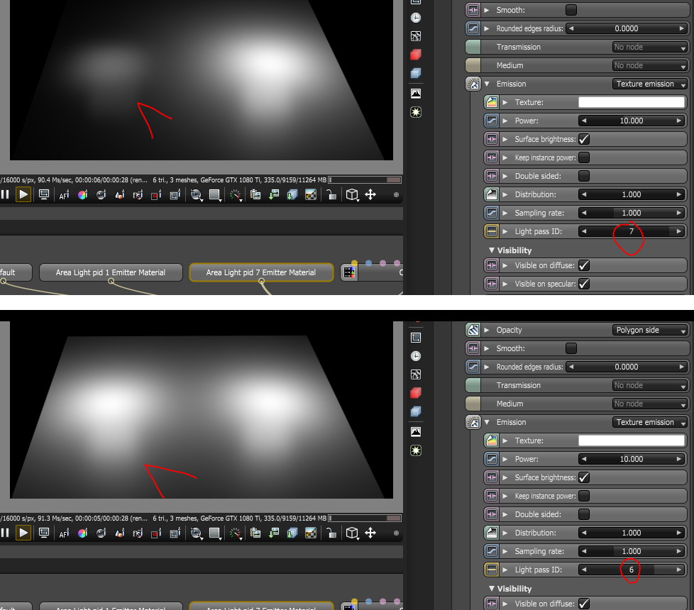

Guys I posted a bug in the last thread, which causes lights to render differently if the material emission light pass ID is 7 and 8
viewtopic.php?p=344928#p344928
I'm still seeing it

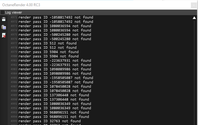

This file is generating lots of render pass ID errors in the log
1. Load the attached orbx.
2. Click the render target to start rendering
3. Go to windows > create log window
P.S. Shouldnt octane warn the user there are errors in the log? It's not giving any warnings
render_pass_id_log_errors.orbx
(449.98 KiB) Downloaded 340 times
Win10 Pro / Ryzen 5950X / 128GB / RTX 4090 / MODO
"I am the resurrection, and the life: he that believeth in me, though he were dead, yet shall he live" - Jesus Christ
roeland
Posts: 1826
Yes we will fix this bug, it happens if you enable a lot of render passes.
