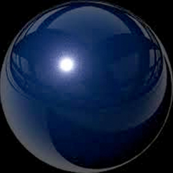

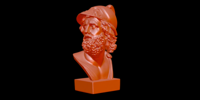

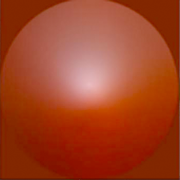

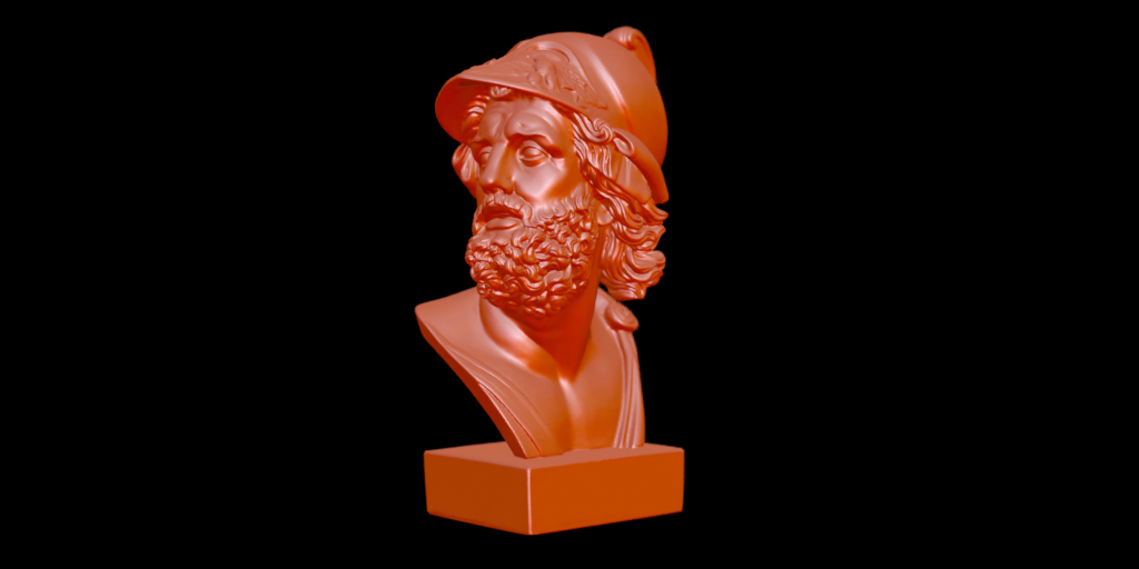

- matcap
- zbrush.png (90.91 KiB) Viewed 1583 times

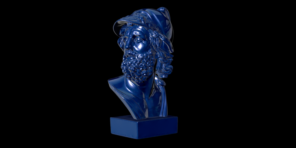

- carpaint matcap
- carpaint.png (104.71 KiB) Viewed 1583 times
