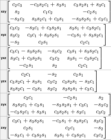

thanks to Sighman, i have brush up on my matrix math a bit :)
to tell the truth, i have found an interesting link on wikipedia with all the transformation matrix:
http://en.wikipedia.org/wiki/Givens_rotation
i've made a big step forward for my c4d script, now with the XYZ matrix i can rotate an object on all the three axis one at a time, in plus simultaneously on X and Y; with the XZYmatrix simultaneously on Y and Z; with the ZYX matrix simultaneously on X and Z.
unfortunately i can't find the correct matrix for a complete rotation on all the axis simultaneously :(
now, could someone point me in the right direction for the final matrix that gives the trasformation on all the three axis simultaneously?
and what about the scale? how does the scale interact with the matrix?
thanks in advance
ciao beppe

@bepeg4d, doesn't C4D scripting system have a linear algebra library you can use? Any respectful scripting system would expose object transforms directly as matrices and allow you to create rotation, scaling & translation matrices with-out this mathematical hassle of calculating each term yourself. If C4D has such support, then you should consider investigating it, because this approach you are doing requires good mathematical knowledge (while the other approach requires only lousy mathematical knowledge :) ) Don't reinvent the wheel!

bepeg4d wrote: ...now, could someone point me in the right direction for the final matrix that gives the trasformation on all the three axis simultaneously?
thanks in advance
ciao beppe
If you are thinking about exporting C4D into Octane scatter data maybe you'll find this topic useful
http://render.otoy.com/forum/viewtopic. ... 1&start=40
