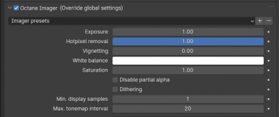

That's all clear to me and nothing I suggested goes against it. This is purely about a rational usage of the UI and how to untangle the confusions/contradictions that are there now. You have no idea how often each day I have to cancel renderings because I forgot to uncheck one of those pesky checkboxes. On an average day this makes me lose probably half an hour in total. Maybe this will get better over time when I have the process "Uncheck checkbox -> Hit F12" internalized. But right now it's really annoying. And if it stays like that I will probably write an override feature into my addon to get around it. But right now it's not working as it is for me.

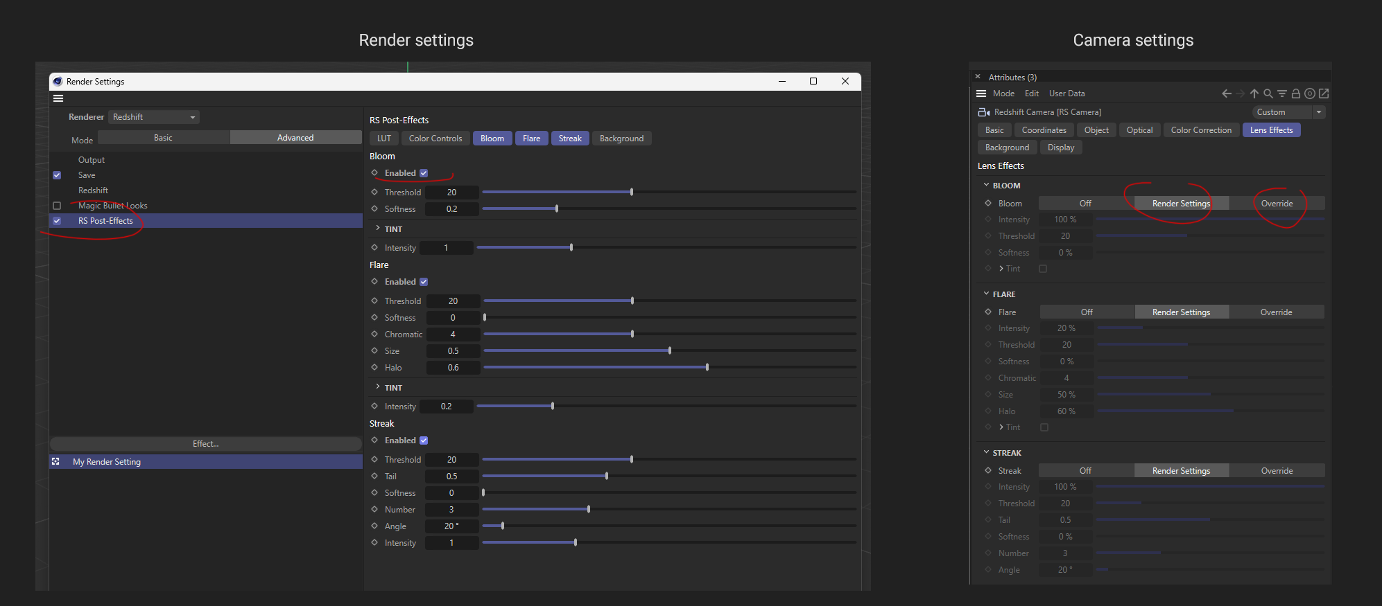

I propose a simple global solution. This could enable imager or post settings for all cameras or disable it. If user wanted to use other imager/post setting there should be a toggle to override global settings for a selected camera. This workflow is used in Octane plugin for C4D or Redshift and works fine. Zero confusion.
Example from Redshift:

Principially I don't mind global settings. But not sure if it make things easier or less confusing. We would now have three Octane Imager panels - unless you want the replace the "Preview Mode" one with the "Global Settings" one. Then it's two again. And then it's basically the same thing that I suggested above - just different labels. We still have to think about switching in and out of Camera Perspective. I would want to have an option to get away with not switching settings back and forth.

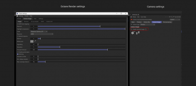

In general Octane Imager and post settings are integral parts of OctaneRender engine. They can be disabled but they have basic image correction tools that are very useful and worth using. Consider Imager as a Color management tools for Blender Cycles.
Since they can be enabled for any camera in a scene it is easier to control different renders having separate controls (eg different exposure setting for each camera). Imagine how inconvenient it would be having it globally for all cameras.
Sometimes just one exposure setting or OCIO is enough for all cameras in a scene that's why there is a global settings in 3d preview window. At the moment the imager and post settings workflow process and naming needs to be simplified, preferably as it is done in C4D or as in my earlier examples.
Here is the sample from Octane C4D:
