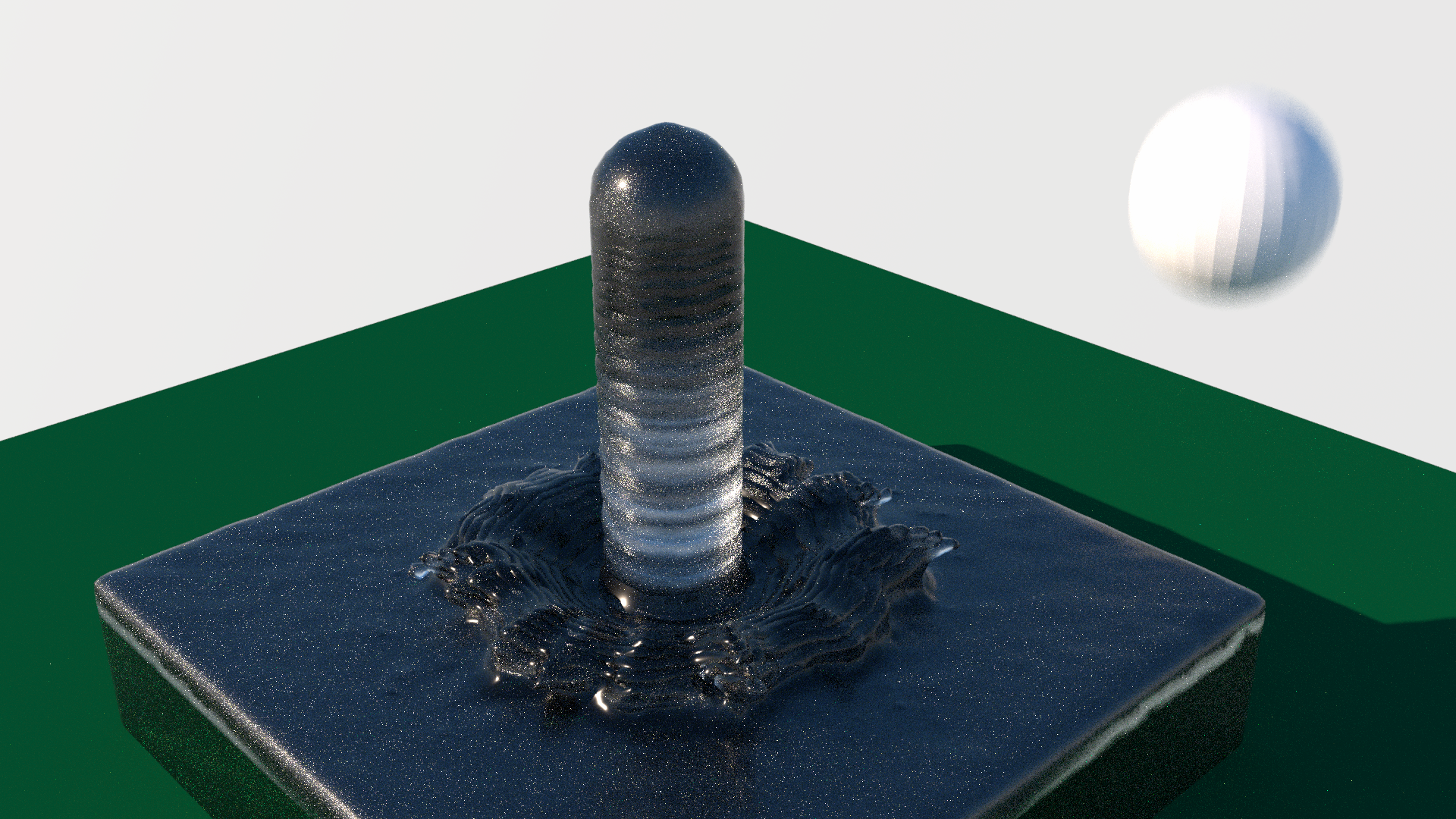

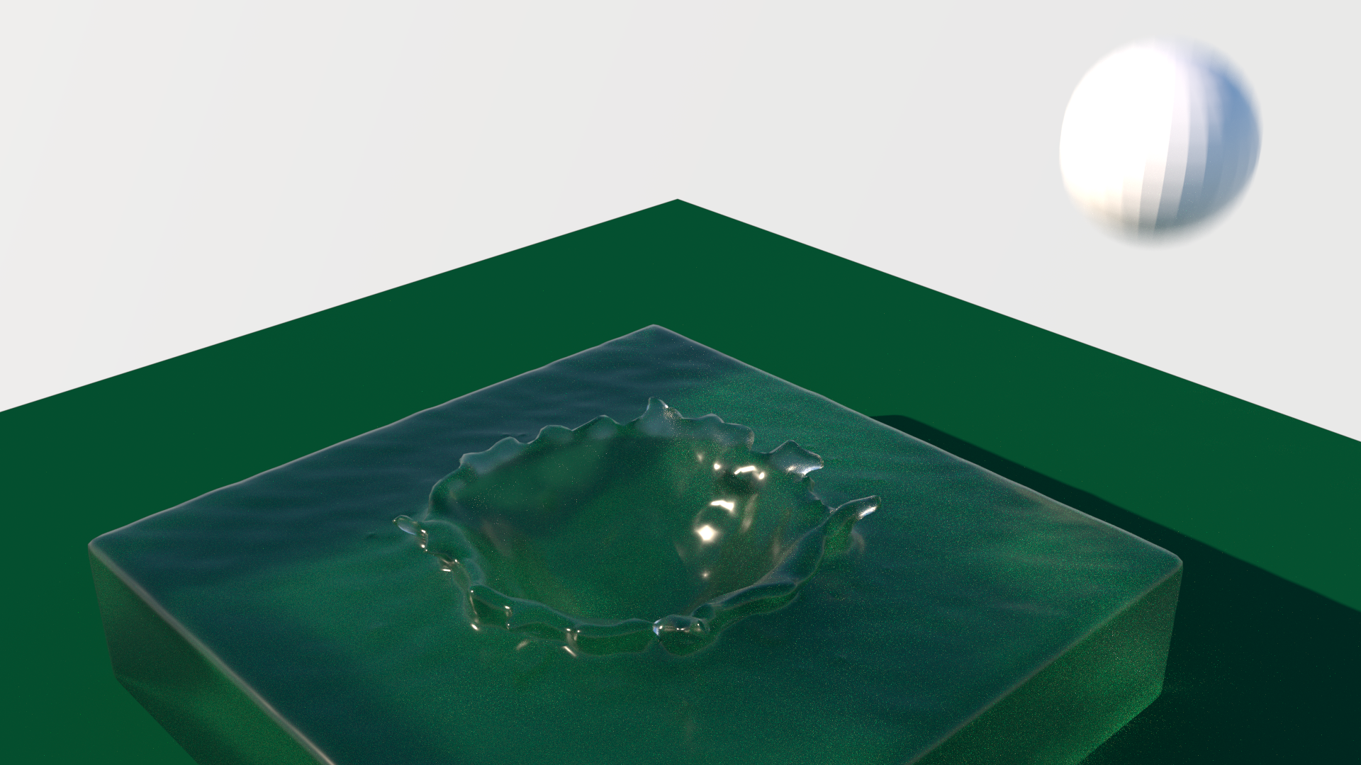

I spent some time looking at this but wasn't able to get it to work. I think I know what the problem is though. When I was testing I also put a rigid body sphere in the scene as well so I could see if I could get it to do motion blur as well. This is the interesting part of this. I ran the simulation for the fluid and then ran the simulation for the sphere, but I did this before I assigned the sphere object's geometry type. Then I set the geometry type to "movable proxy" and rendered one of the frames. Both the fluid and the sphere had no motion blur. So I re-ran the simulation of the sphere and all of sudden the motion blur for it started working. It's definitely an order of operations thing. So I set the geometry type to the fluid objects to "moveable proxy" and re-ran the fluid simulation, but it didn't work. I think that there is something missing with the fluid simulation and the fluid objects don't get the flag set for motion blur. I suspect it's because the fluid objects are generated from other objects and the plugin doesn't see those objects as having the correct geometry type.
Here is what the render looks like:
I exported a orbx file so I could see if motion blur would work in stand alone, but that didn't work out very well either. :( Instead of the object moving it just brought each frame in as another object.
Looks like a bug to me.
