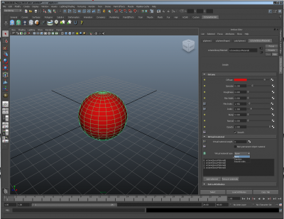

In Maya the virtual material is implemented like this:
Octane engine does not support such nodes, so the plugin will be forced to implement its own way how to randomize complex values.
I already wrote you about one of the ways HERE... Anyway, before this feature will be available in Octane engine - we can not use the similar setup with random simple values in special nodes. The plugin can only operate by nodes about which Octane engine knows.

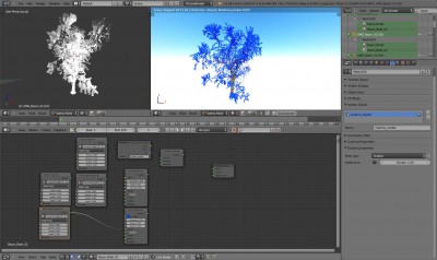

What about the "Attribute-Node" of Cycles (sorry for asking again
Will there be a possibility to use the Vertex Paint to mix Shaders ?
See example here (doesn't work): Kind regards
