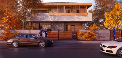

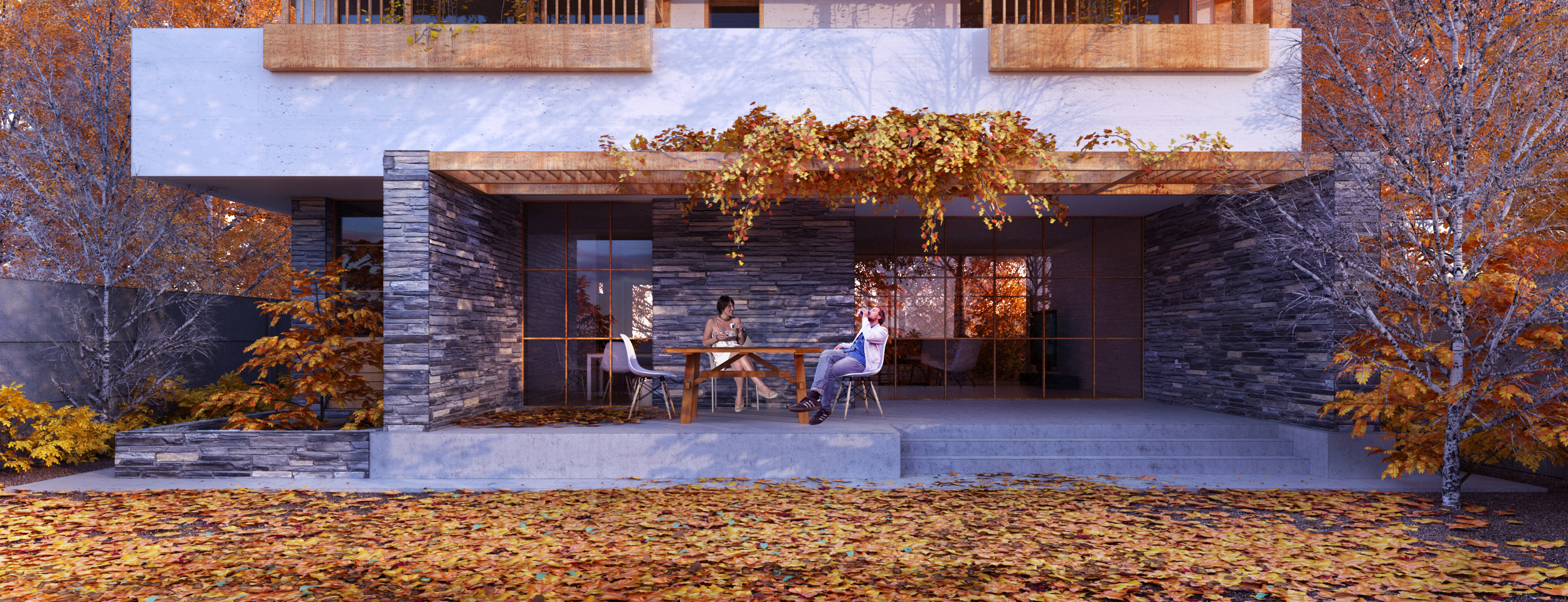

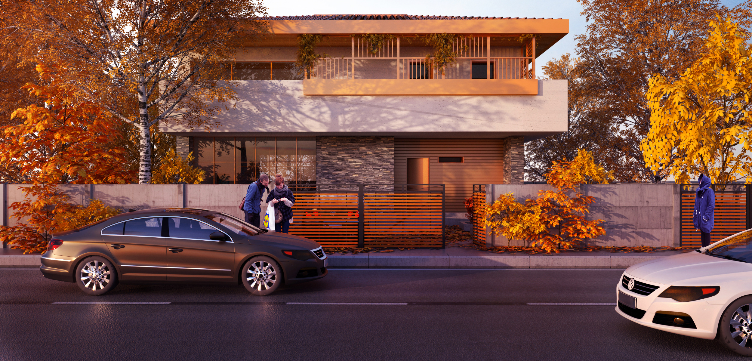

y have tested the proxy , it works just perfect,but i detected a problem on a big scene ,(see atached images ) when i hit render it loads the scene , but after this , only the hdri bakround/enviorement appears in the render window
in version 0.15.2 , i was able to render the scene , so i don't think that this is a low memory issue
