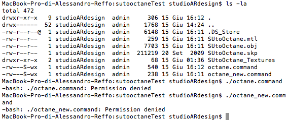

1) I think there's a problem regarding Permissions:
see: http://www.mac-forums.com/forums/360420-post2.html

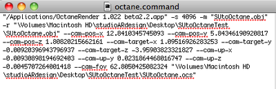

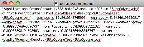

2) If I remember well OSX only uses forward slashes / in paths, while in the .command file there's a mix of both / and \ :

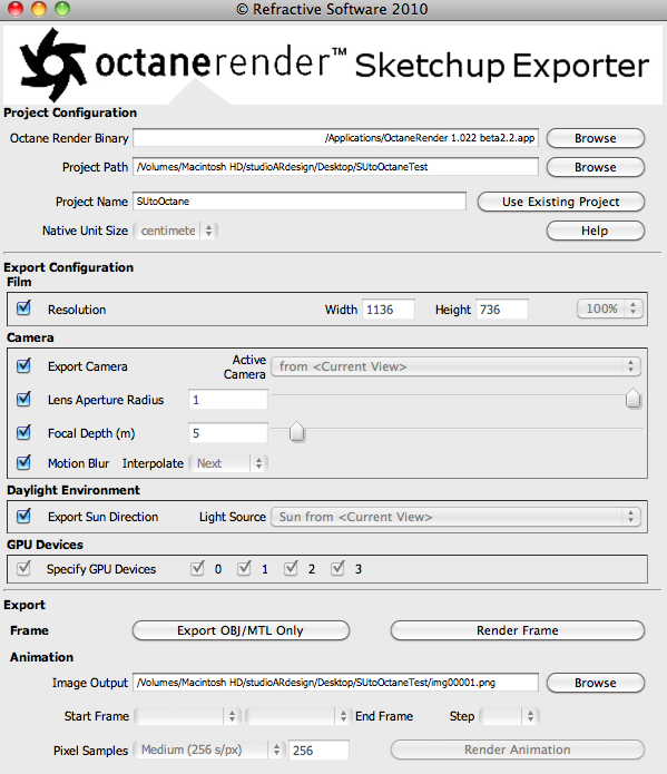

4) Since you talked about GPU devices check... I'm not able to change any of the parameters since they're all greyed out (along with some others):
